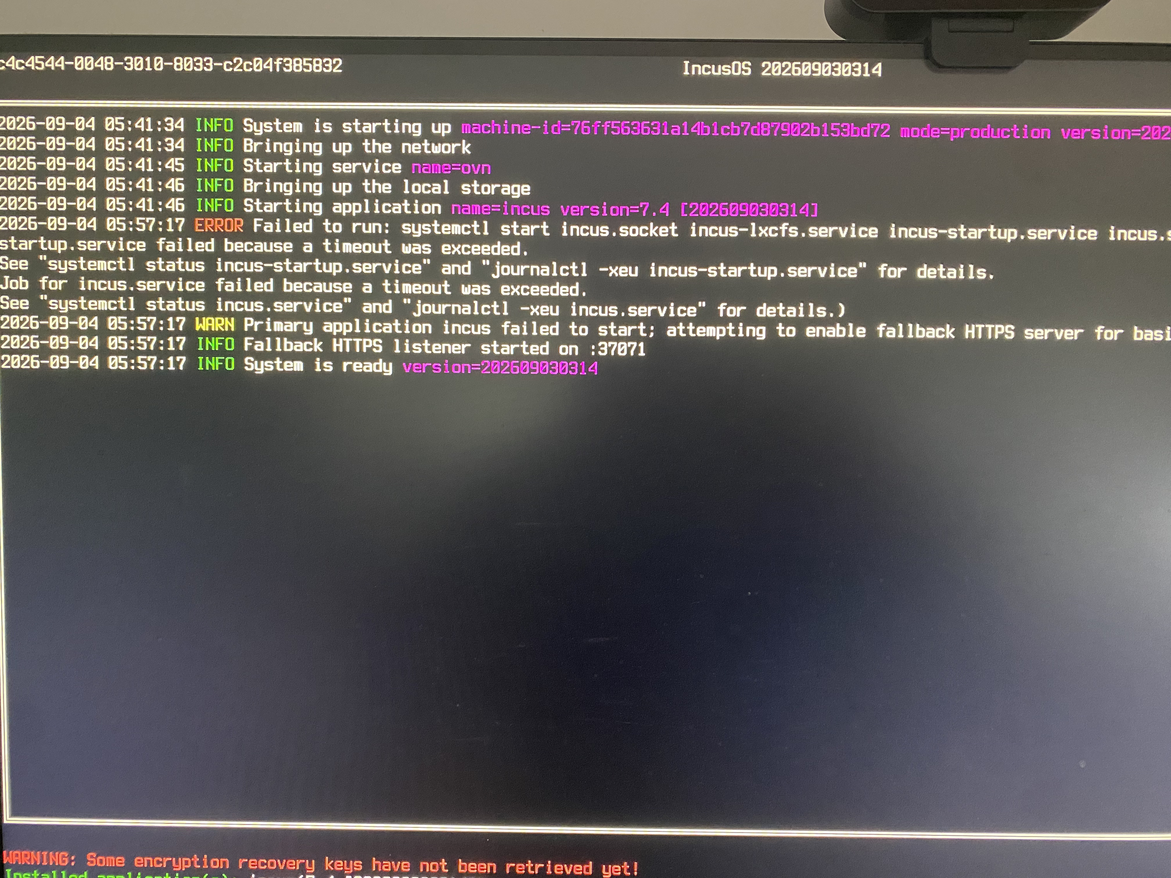

I have a three-node cluster, provisioned via Operations Center. Manually triggered (via UI) a rolling update, and the first node in the cluster became unresponsive (step 1/27). When I connected a monitor there was a message along the lines of the system had updated and needed restarting. That was unexpected - I assumed the process would be automatic - but I restarted the node.
It didn’t come up properly, hanging at the ‘Starting application …’ step for around 15 minutes (see image) and then failed.

Are you able to interact with that fallback listener? It would be good to be able to pull some more detailed logs from that system to see what’s going on exactly.

I’ve tried using incus remote add ... with the temporary listener port and both tls and oidc auth, but rejected with 403 Forbidden both times.
@accuser try something like:
curl -k -s --cert .config/incus/client.crt --key .config/incus/client.key "https://IP-ADDRESS:37071/1.0/debug/log?boot=0&entries=300&unit=incus"
> curl -k -s --cert ./client.crt --key ./client.key "https://192.168.71.2:34945/1.0/debug/log?boot=0&entries=300&unit=incus"
Forbidden
It looks like the fallback listener is using a client cert generated by Operations Center (OC). OC was seeded with my client certificate, and I’ve confirmed that this is beign used by its own fallback listener (at least in the config). But the nodes have OC’s self-signed fallback certificate, which I guess is why I’m getting a 403.

Ah yeah, it gets initially configured with the trust certificate provided during installation which when Operations Center is used is the Operations Center client certificate.
You could grab that certificate by making a backup of Operations Center. Though it would also be a good idea to set additional certificates in the fallback listener config to include an emergency certificate that you keep in storage somewhere for such situations.
