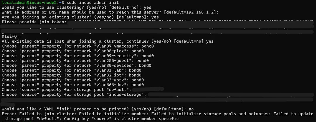

However this has been a slow migration as I rebuilt my container and VMs and did a full migration. I have finished that and I have to say I am SUPER pleased with the results and how Incus handles the environment. However now I am looking to add my other nodes to my incus environment as a cluster to make my containers HA. I am running into issues with the incus admin init to turn the cluster on with the new host.
When I run the command I confirm that yes I want to wipe it’s config (nothing on this new host) and then I assign the networks as I am doing MACLAN for VLAN pass-through so I don’t have to NAT everything through the host. Trying to keep it as close to Hyper-V / VMWare network as possible. The issue arises when the wizard asks about storage. I have two Default which is just the incus host and then incus-storage which is on my TrueNAS using the TrueNAS driver from github. I do not know what to put as “source” to get it to accept and share/re-use that storage path for HA potential.
Here is a screenshot of the wizard / output from the new host. Any help or guidance would be great. I will eventually have a third node to add but I am doing this in “baby” steps as this is all 100% new to me.
The error suggests that the system being joined may have a pre-existing default storage pool, conflicting with the definition from the cluster one.
Systems joining the cluster must be completely empty, that is, not have any storage pool or managed networks defined.

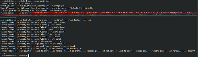

@stgraber - Fresh install and same result. I am 100% sure it is because I do not know what to put as the “source” of storage pool “default” and storage pool “incus-storage”
Those are on my other node that is already running my containers etc. So to recap this is 100% fresh install on what we will call node2. Node1 is already working and running what I would consider production payloads.

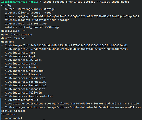

Use incus storage show POOL --target EXISTING-SERVER to look at the value for an existing server.
Here is the output of that command.
Okay, so looks like the TrueNAS poolneeds VMStorage/incus-storage in your environment which probably lines up with the pool and dataset name on the TrueNAS side.

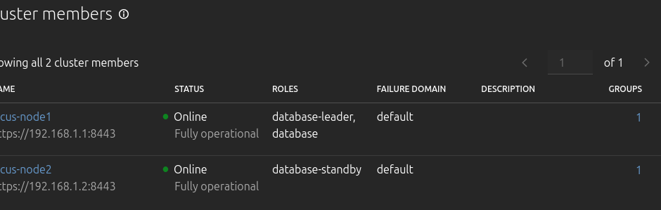

correct - I re-ran the incus admin init and set the values for both the storage pools and no errors. I am validating that this is working and that incus-node1 shows incus-node2 . and it shows SUCCESS!
