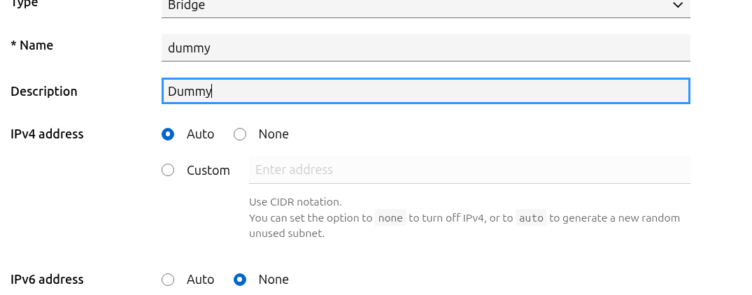

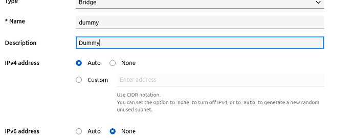

Here’s what happens on the old UI:

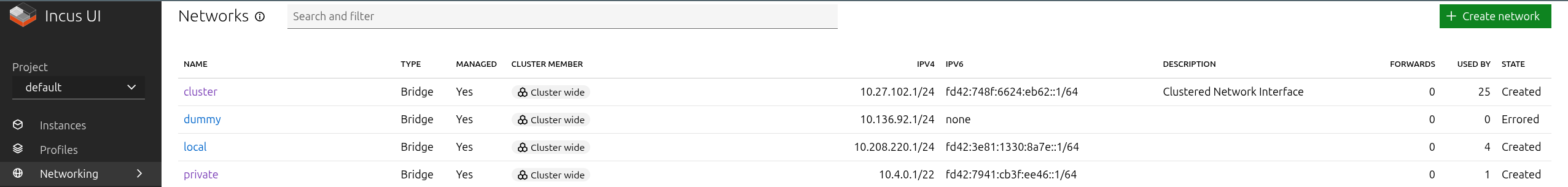

I save, and it seems to go ok, but then when I look at the networks;

Tried to create network again;
POST https://192.168.1.204:8443/1.0/networks?project=default net::ERR_NETWORK_CHANGED
Same thing, shows errored state in networks.
