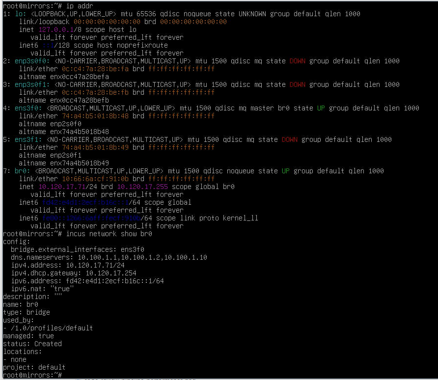

Many thanks. Actually I tried this before but failed, and I configed a managed bridge to do it, but still failed
the route:
default via 10.120.17.254 dev br0
0.230.17.0/24 dev br0 proto kernel scope link src 10.120.17.71
Your br0 is incus managed bridge, you should be using unmanaged bridge which is not created by incus if you want your instances to be in the same lan with host.
Thanks, It works with a unmanaged bridge
