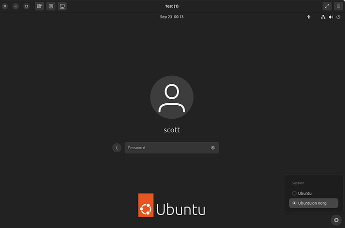

Here’s where I set Xorg as you mentioned.

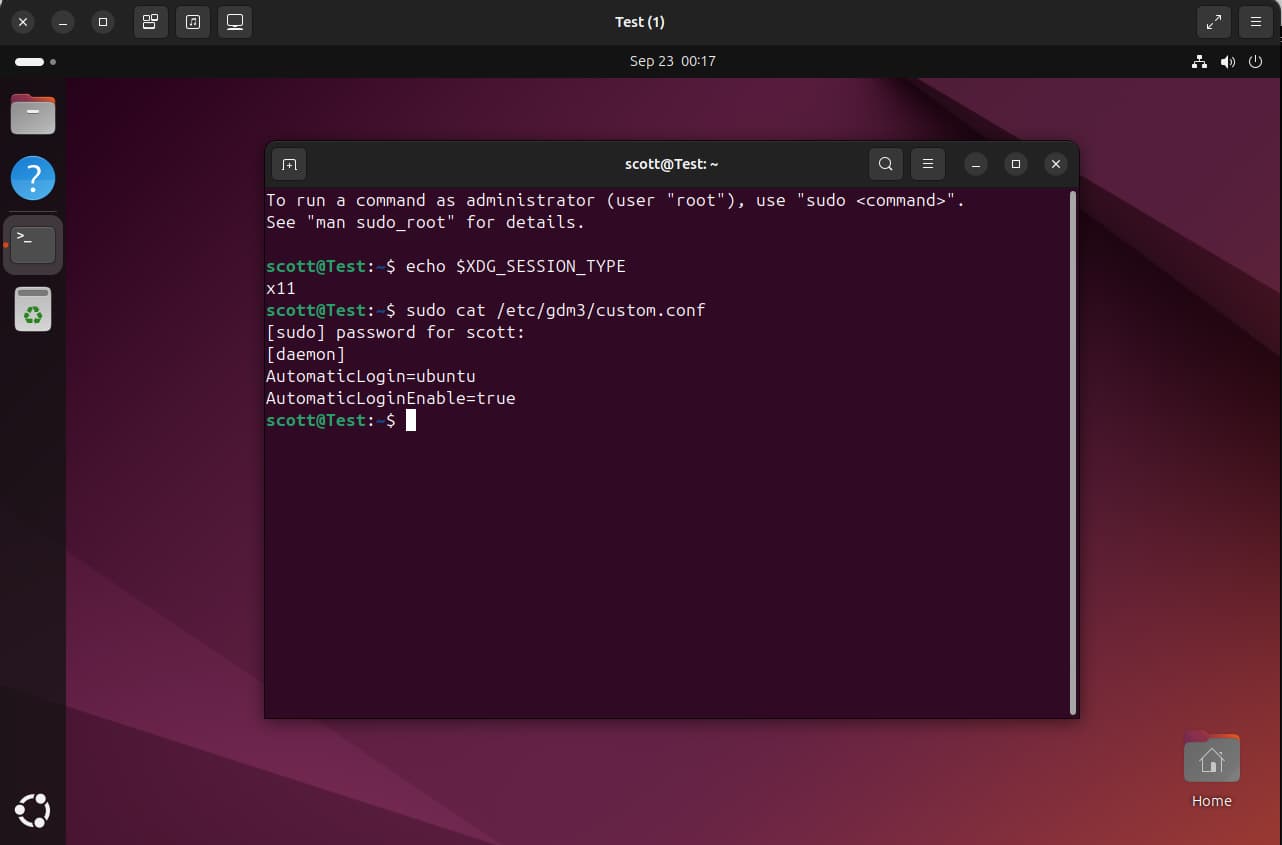

and that does sign me in as Xorg.

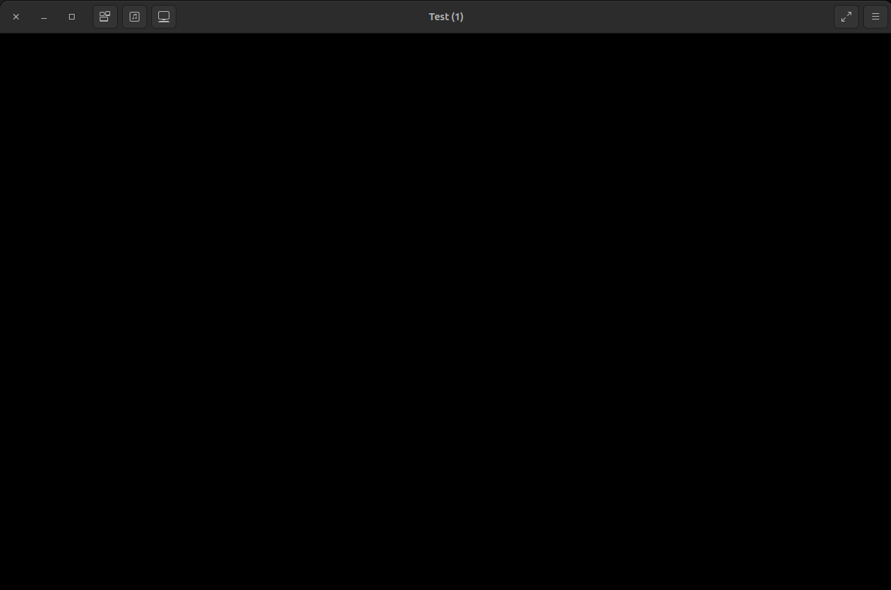

Once I reboot, no display.

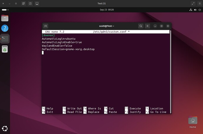

So, the issue is that I want an incus VM that always starts X11 rather than Wayland. I know I can use the gear as above, but I need the VM to boot with X11 as the default. Normally I could:
sudo nano /etc/gdm3/custom.conf
and add these lines:
[daemon]
WaylandEnable=false
DefaultSession=gnome-xorg.desktop
This works with a QEMU VM, but not with an Incus VM.

That worked for connecting via Mesh Central, but the Incus remote viewer now shows a black screen.
