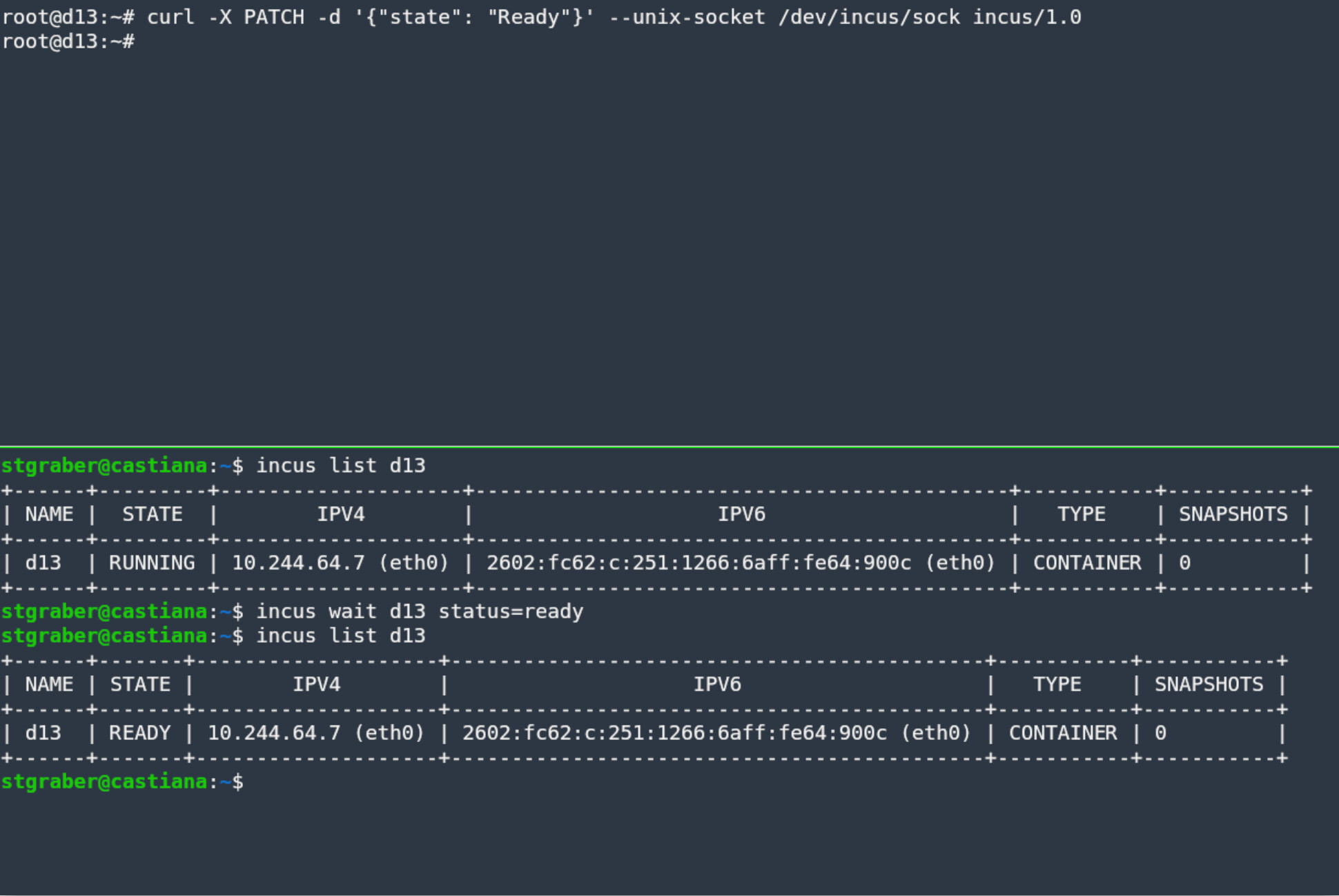

We’d rather not have incus wait start running commands inside of the instance which is what you’d need to do to check on cloud-init status.
That said, you could probably have cloud-init set the instance state to READY and then have incus wait wait for that.
I guess that’s how it’s supposed to be, right? but this stucks.
incus launch images:debian/13/cloud testcloud ; incus wait testcloud status=ready ; incus exec testcloud – ls -al /home/debian
