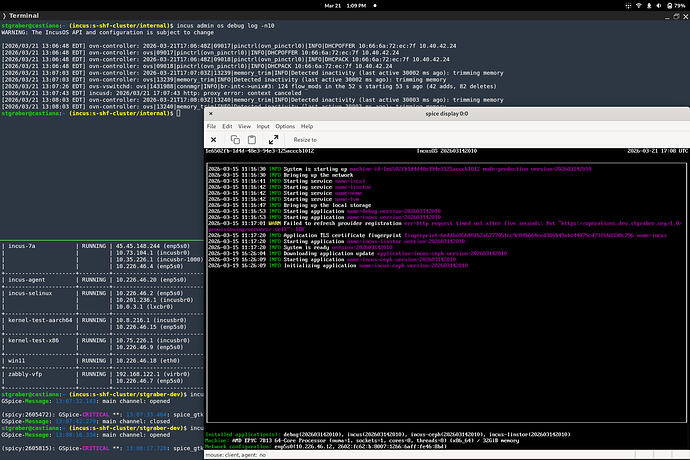

Where are you seeing AM/PM?
Both on-screen and remote logs show in 24h format here.
