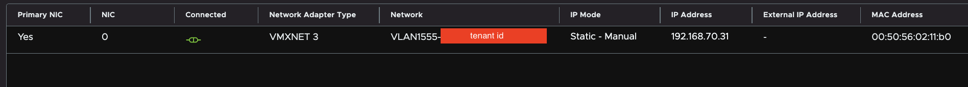

The network interface for the virtual machine:

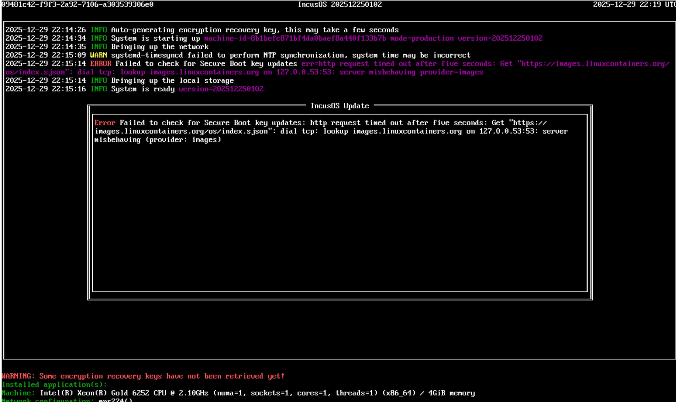

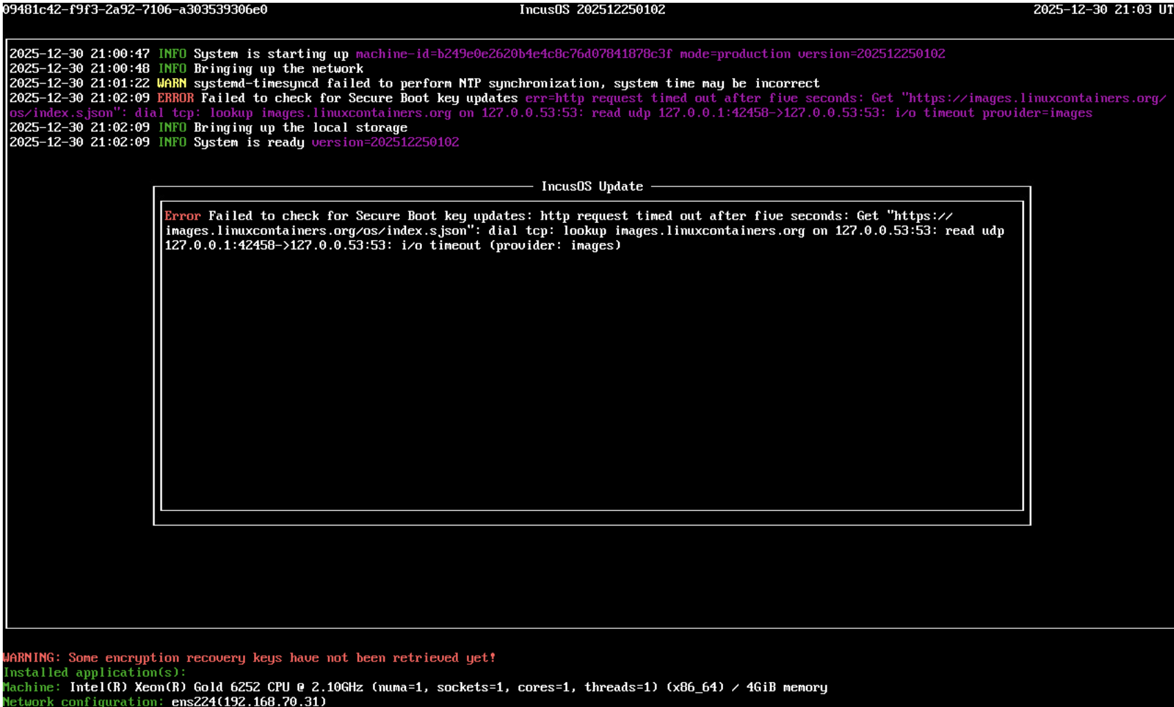

Progress using your network seed! It is now showing an IP address on the interface, but it is not responding to connection attempts and shows that it “failed to check for secure boot key…”
I have verified the gateway IP and the DNS server are correct (they match the configuration on another linux server). I am also remote today. The logs aren’t showing traffic via VPN, so I may have to just try when I am in the office tomorrow.
Ah yeah, that’s starting to look better.
The error would be consistent with failing to reach the DNS server. It may be worth trying to ping the IncusOS box from another VM on that network just to make sure that basic connectivity is good now.
