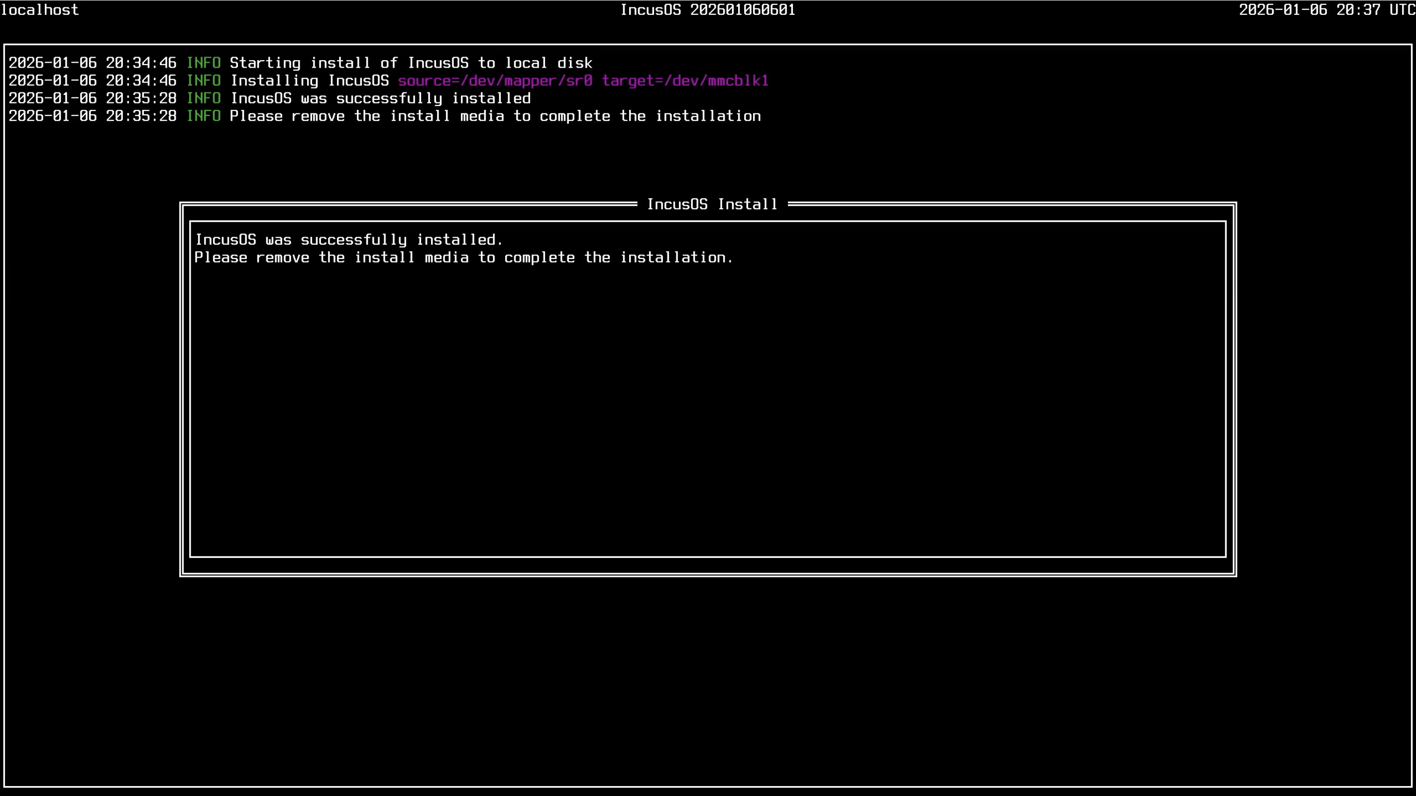

Okay, so we’ll definitely need to add sdhci_pci to the initrd to allow for boot post-install.
@gibmat can you think of any reason why the install logic wouldn’t allow installing on this?
base: Add sdhci_pci by stgraber · Pull Request #760 · lxc/incus-os · GitHub will add what we need for post-install boot handling
At a minimum we’ll need to update this logic to also recognize mmcblk devices: incus-os/incus-osd/internal/install/install.go at main · lxc/incus-os · GitHub
If we can emulate an eMMC device in QEMU it should be pretty easy to work though any other issues.

Made progress with the testing channel but now getting stuck during the copying phase. Partition 2 of 5 completes and then I get the following error. The existing disk has (had?) two partitions and I believe I’d selected the option to wipe the target disk but I’ll create another image just in case.
On second look, not sure why it’s targeting mmcblk1

Huh. Tried it a second time without changing anything just for fun. Seemed to work. ¯\_(ツ)_/¯
Interesting, I wonder what got it to try mmcblk1 the first time around…
I can’t power cycle the machine remotely at the moment so I’m stuck until I can get to it but I’ll see if I can reproduce it later.

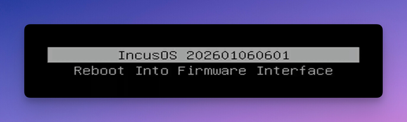

Even weirder. Got the machine to reboot. Got this:
That’s odd, I wonder what’s causing the numbering of the mmcblk device to change…. under the hood we rely on the KName field returned by running lsblk to get the list of possible install target devices. I’d expect device naming to be stable from one boot to another.
Have you defined any install target in the seed configuration?
Post-install, does IncusOS start up properly on the system?
So the machine installed itself again after reboot?
The message at the top shows it booting from a CD-ROM drive (/dev/mapper/sr0), was the install media correctly disconnected before reboot?

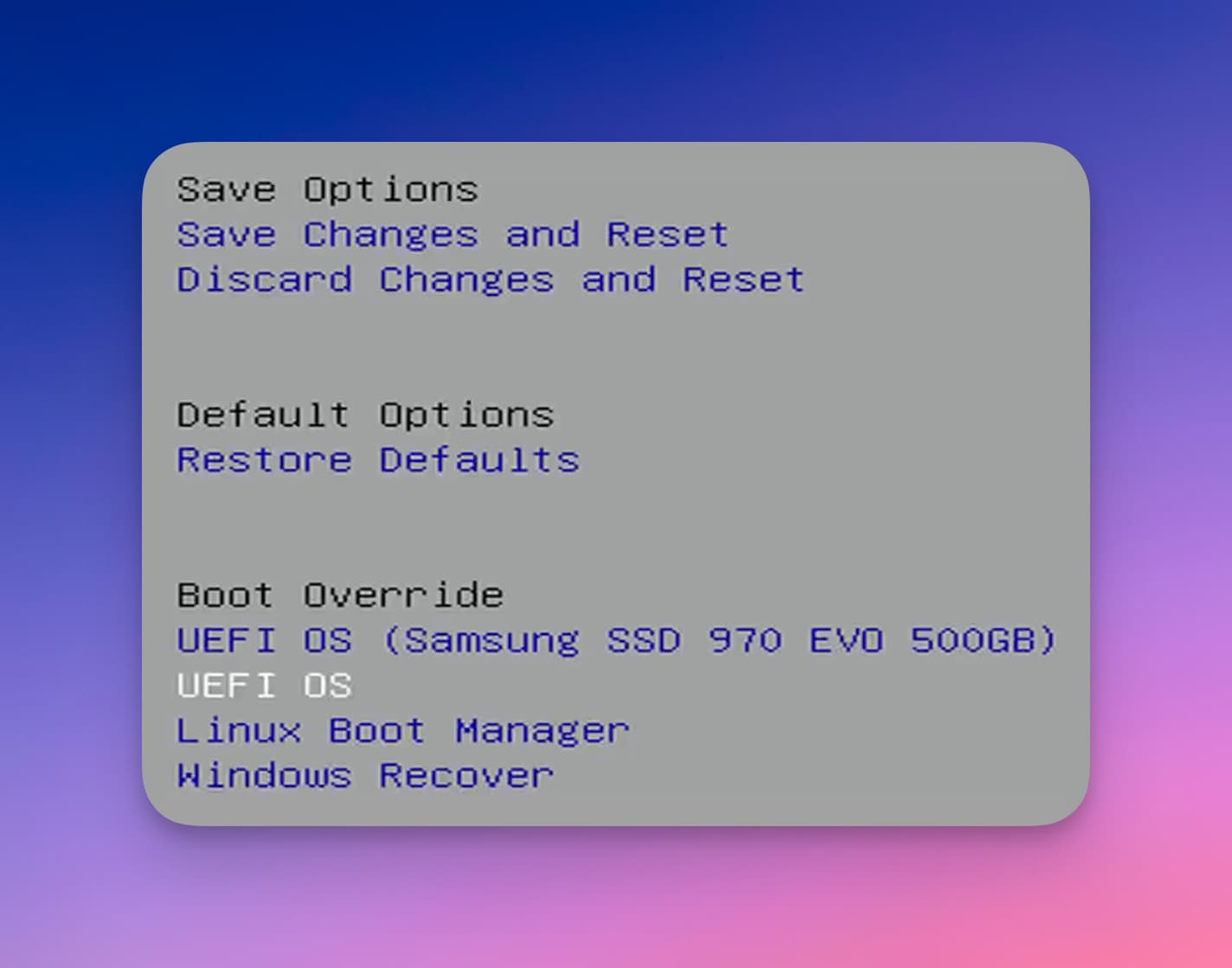

Trying it now but does not appear to. I have two new boot options for UEFI OS and Linux Boot Manager (the other UEFI boot device is a separate drive that has Ubuntu Core on it):
Selecting either of those entries results in the boot selection screen:
From there, screen goes blank and no network activity. I don’t have physical access to the machine at the moment but I can reboot it at that point with CTRL+ALT+DEL so it doesn’t seem totally hung.
