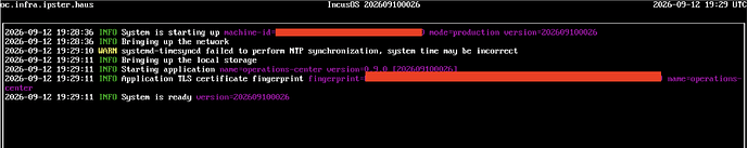

Currently setting up a VM on an IncusOS host to run Operation Center. Everything works just fine except the time synchronization. If I configure a public NTP server using a FQND (time.nrc.ca) I am getting the following WARNING.
No issue if I use an internal IP as the NTP server.
Relevant configuration is as follow:
 dns:
    domain: infra.ipster.haus
    hostname: oc
    nameservers:
      - 10.21.41.1
    search_domains:
      - haus
    dns_over_tls: true
  time:
    ntp_servers:
      - time.nrc.ca
    timezone: UTC
There is no DNS request at all coming in on 853 for a DNS resolution.
The VM is able to communicate with outside since it downloads the images and such.
Anything I should look for ?
Here are some part of the logs:

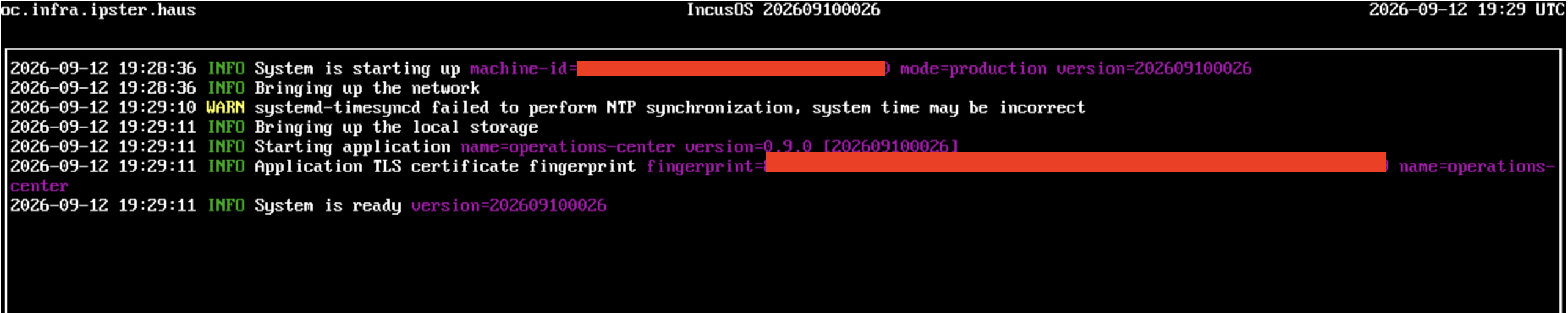

Sep 12, 03:34:44 p.m. oc.infra.ipster.haus systemd[1]: Stopping systemd-timesyncd.service - Network Time Synchronization...
Sep 12, 03:34:44 p.m. oc.infra.ipster.haus systemd[1]: systemd-timesyncd.service: Deactivated successfully.
Sep 12, 03:34:44 p.m. oc.infra.ipster.haus audit[1]: SERVICE_STOP pid=1 uid=0 auid=4294967295 ses=4294967295 subj=unconfined msg='unit=systemd-timesyncd comm="systemd" exe="/usr/lib/systemd/systemd" hostname=? addr=? terminal=? res=success'
Sep 12, 03:34:44 p.m. oc.infra.ipster.haus systemd[1]: Stopped systemd-timesyncd.service - Network Time Synchronization.
Sep 12, 03:34:44 p.m. oc.infra.ipster.haus audit: BPF prog-id=70 op=UNLOAD
Sep 12, 03:34:44 p.m. oc.infra.ipster.haus audit: BPF prog-id=71 op=LOAD
Sep 12, 03:34:44 p.m. oc.infra.ipster.haus audit[1]: SYSCALL arch=c000003e syscall=321 success=yes exit=84 a0=5 a1=7fff2dceca80 a2=98 a3=0 items=0 ppid=0 pid=1 auid=4294967295 uid=0 gid=0 euid=0 suid=0 fsuid=0 egid=0 sgid=0 fsgid=0 tty=(none) ses=4294967295 comm="systemd" exe="/usr/lib/systemd/systemd" subj=unconfined key=(null)
Sep 12, 03:34:44 p.m. oc.infra.ipster.haus audit: PROCTITLE proctitle="/init"
Sep 12, 03:34:44 p.m. oc.infra.ipster.haus systemd[1]: Starting systemd-timesyncd.service - Network Time Synchronization...
Sep 12, 03:34:44 p.m. oc.infra.ipster.haus systemd[1]: Started systemd-timesyncd.service - Network Time Synchronization.
Sep 12, 03:34:44 p.m. oc.infra.ipster.haus audit[1]: SERVICE_START pid=1 uid=0 auid=4294967295 ses=4294967295 subj=unconfined msg='unit=systemd-timesyncd comm="systemd" exe="/usr/lib/systemd/systemd" hostname=? addr=? terminal=? res=success'
Sep 12, 03:34:45 p.m. oc.infra.ipster.haus incus-osd[651]: 2026-09-12 19:34:45 WARN systemd-timesyncd failed to perform NTP synchronization, system time may be incorrect
Cheers !
Did you try specifying the NTP server by IP address to see if it’s some issue with DNS availability at that stage of the boot?
Yes, same behavior.
It that matter, when the host up, changing network parameters invoke a network reload and throws the same error.
FWIW, network is statically configured (IPv4) with SLAAC for IPv6.
Therefore, routes (default) is created once ip address is assigned.
Hopefully incus-osd/network: Stop restarting systemd-timesyncd every 2.5s by stgraber · Pull Request #1360 · lxc/incus-os · GitHub will help
