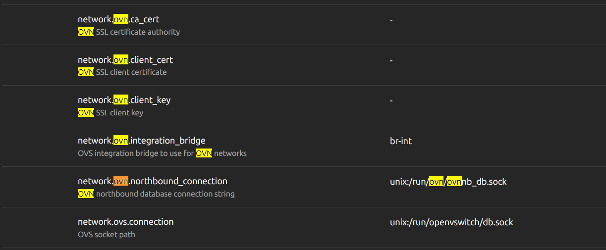

chase@DESKTOP-2TUBIB8:/mnt/c/Users/Chase$ incus config trust add-certificate ~/incus-ui.crt
chase@DESKTOP-2TUBIB8:/mnt/c/Users/Chase$ incus config get network.ovn.ca_crt
chase@DESKTOP-2TUBIB8:/mnt/c/Users/Chase$ incus config get network.ovn.client_cert
chase@DESKTOP-2TUBIB8:/mnt/c/Users/Chase$ incus config get network.ovn.client_key
chase@DESKTOP-2TUBIB8:/mnt/c/Users/Chase$ incus config get network.ovn.integration_bridge
chase@DESKTOP-2TUBIB8:/mnt/c/Users/Chase$ incus config get network.ovn.northbound_connection
chase@DESKTOP-2TUBIB8:/mnt/c/Users/Chase$ incus config get network.ovn.network.ovs.connection

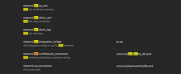

I think it’s interesting that those configs aren’t returning anything when they’re present in the WebUI
chase@DESKTOP-2TUBIB8:/mnt/c/Users/Chase$ incus config set network.ovn.integration_bridge incusbr0
chase@DESKTOP-2TUBIB8:/mnt/c/Users/Chase$ incus config set network.ovn.northbound_connection unix:/run/ovn/ovnnb_db.sock
chase@DESKTOP-2TUBIB8:/mnt/c/Users/Chase$ incus config set network.ovn.network.ovs.connection unix:/run/openvswitch/db.sock
Error: cannot set 'network.ovn.network.ovs.connection' to 'unix:/run/openvswitch/db.sock': unknown key
chase@DESKTOP-2TUBIB8:/mnt/c/Users/Chase$ incus config set network.ovn.network.ovs.connection /run/openvswitch/db.sock
Error: cannot set 'network.ovn.network.ovs.connection' to '/run/openvswitch/db.sock': unknown key
incusbr0

Bringing this back up, I tried to enable OVN by editing incus admin os service show ovn and I wasn’t able to quite figure it out.
When reviewing https://linuxcontainers.org/incus-os/docs/main/reference/services/ovn/, it didn’t give me too much guidance, so I tried just setting the config to enabled, then the tunnel_address and tunnel_protocol, and eventually, it seemed to accept the config after I added the database string with all three IPs. But I was never able to get it to update the state.
I had this config on all three nodes:
  database: tcp:10.40.0.2:6642,tcp:10.40.0.3:6642,tcp:10.40.0.4:6642
  enabled: true
  tunnel_address: 10.40.0.2
  tunnel_protocol: geneve
state: {}
(Other two nodes had their own IP in tunnel_address)
After I set that config on all three nodes, I tried to set network.ovn.northbound_connection: tcp:10.40.0.2:6642,tcp:10.40.0.3:6642,tcp:10.40.0.4:6642 inside of incus config edit, which didn’t take either.
Is there something I’m missing?
