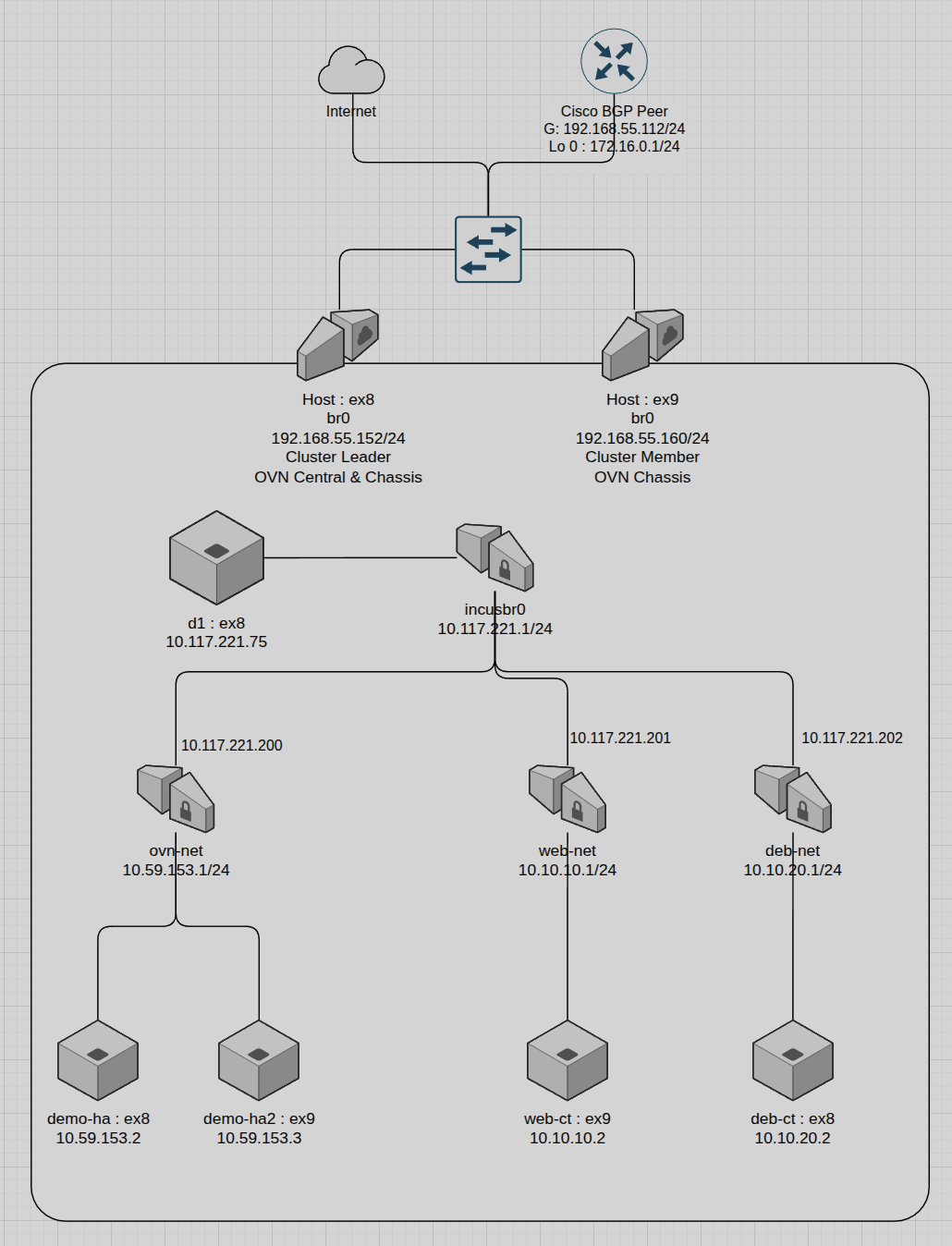

How to routing inside incusbr0, specially demo-ha line contaiers from outside d1 or BGP Peer?
Reference with Incus doc and Gemini I created below topology.
From BGP Peer can ping to 10.117.221.75
R1#sh ip route
B        10.117.221.75 [20/0] via 192.168.55.152, 03:27:29
I also configed external-ip 10.117.221.200, 201, 202
Those are not installed BGP Peer routing table.

even at d1, can’t ping to incside incusbr0
I added route to incusbr0.

And, the BGP Peer also annouce route 172.16.0.0/24.
But I can’t find this route on ex8.
Could you show me what I have wrong?
