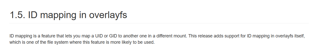

I probably found the root cause, I forgot that idmapped mount for overlayfs is not possible with a kernel older than 5.19.
And that’s why Docker is complaining IMHO
Wow, that’s significant info that should be mentioned somewhere in the docs next to the zvol documentation, as it impacts the latest Ubuntu LTS version and the main use case for zvols. I guess I’ll be upgrading the kernel and we’ll see.
