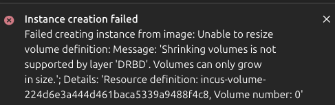

Greetings all, I just setup a incus cluster with linstor as the backend. I have this setup somewhere else and it works fine. But I cant seem to make a vm or a container less than 10GB , otherwise I get the following error.

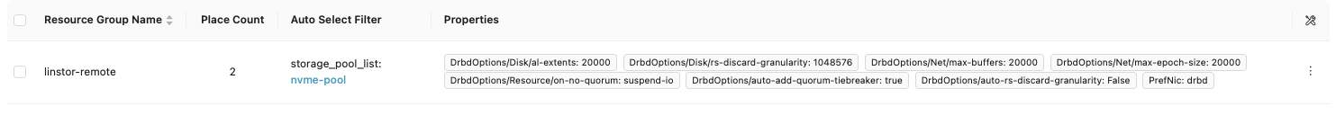

The drives are lvm thin, im kinda scratching my head on this one. I would like for the default value to be maybe 4 GB not 10.
I have tried running the override and also just setting up in profile, but I still cant get smaller volumes. If I create the volume in linstor it does work, but that kinda defeats the purpose. Can anyone help me ?

LINSTOR unfortunately disabled shrinking DRBD volumes recently. I suggest you to set the volume.size property on your storage pool to the value you want, like 4GiB.

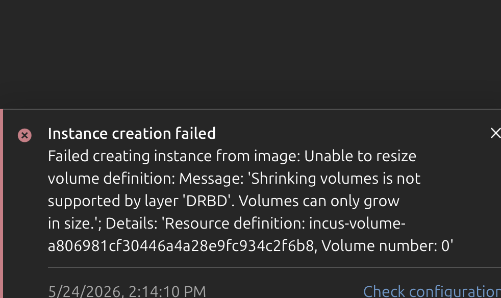

@bensmrs , I have and I get the same error. I was positive I had a way of setting the size (and from what I remember it was from incus that it was set and not in linstor). But this new install is not allowing me to. I guess it’s thinking that all standard size is 10GiB and if I ask for anything else, it fails because it probably cuts out 10GiB before it reads the size override?

root@gigabyte:/home/mihai# incus create docker:guacamole/guacd guacd-1 -d root,size=2GiB --storage linstor-remote -p default -n guacd
Creating guacd-1
Error: Failed instance creation: Failed creating instance from image: Unable to resize volume definition: Message: ‘Shrinking volumes is not supported by layer ‘DRBD’. Volumes can only grow in size.’; Details: ‘Resource definition: incus-volume-7863a7ecb83742b9ad81fa1d1b99ec3a, Volume number: 0’
Fresh install, nothing on there… its so odd

/dev/drbd1012 1.9G 237.5M 1.6G 13% /
On the linstor controller node I see:
# linstor volume-definition list -r incus-volume-d994a147aaa34e6282fcdbf811ba8c7e
┊ ResourceName ┊ VolumeNr ┊ VolumeMinor ┊ Size ┊ Gross ┊ State ┊
┊ incus-volume-d994a147aaa34e6282fcdbf811ba8c7e ┊ 0 ┊ 1008 ┊ 2 GiB ┊ ┊ ok ┊
My cluster is on latest IncusOS 202605181246, incus-linstor 202605181246
bensmrs
(Benjamin Somers)
May 26, 2026, 5:35pm
13
That is similar to my experience (and expectations)
I assume this is something that changed on linstor side?
stgraber
(Stéphane Graber)
May 27, 2026, 6:58pm
15
Yep, they introduced that restriction pretty recently.
So has there been standard call it makes for 10GiB first and then it shrinks it to whatever we setup in the instance config ?
Or was incus calling the right size from the beginning but linstor is just being weird ?
stgraber
(Stéphane Graber)
May 28, 2026, 2:36am
17
Incus has a default volume size of 10GiB, that’s what it will use for any newly unpacked image. If your create a container with a size smaller than that, the container gets a clone of the 10GiB image and that volume then gets shrunk to the configure size.
Because of the Linstor change, this is no longer possible and will fail.
So your options are either to deal with a 10GiB minimum or change volume.size on the pool so Incus uses a size other than 10GiB when unpacking an image.
