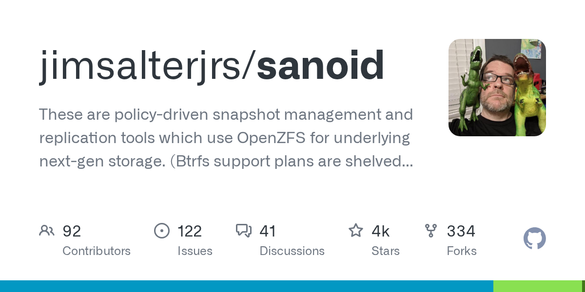

I’m also interested in this feature for situations where the destination server with the backup zpool doesn’t have LXD installed. I think if this PR can get merged, then it should be possibly to use syncoid to do this as follows:
syncoid -r --no-sync-snap --delete-target-snapshots sourcepool user@destination:destinationpool
The --no-sync-snap argument will ensure that syncoid doesn’t create its own temporary snapshot for the sync process (which it normally does) but instead just syncs the existing snapshots that LXD has created. Then, --delete-target-snapshots will ensure that no older (and therefore extraneous) snapshots are left on the destination, so the snapshot list on the destination should mirror the zpool on the source.
