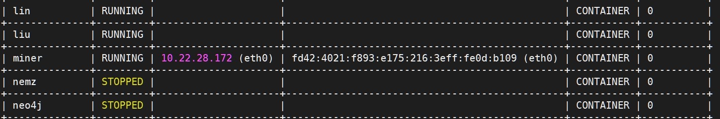

Lxc start (Failed to fchownat(40, memory.oom.group, 1000000000, 0, AT_EMPTY_PATH | AT_SYMLINK_NOFOLLOW ))
I noticed that my container is not starting properly since last week and I would like to seek some help to restore the use of the container and confirm the cause of the error.
I have tried these methods, but I still can’t get it back in use.snap refresh lxd,sudo lxd shutdown,
Here are some error messages:
  • lxc info --show-log demo
lxc demo 20221007095217.286 WARN     conf - ../src/src/lxc/conf.c:lxc_map_ids:3592 - newuidmap binary is missing
lxc demo 20221007095217.287 WARN     conf - ../src/src/lxc/conf.c:lxc_map_ids:3598 - newgidmap binary is missing
lxc demo 20221007095217.288 WARN     conf - ../src/src/lxc/conf.c:lxc_map_ids:3592 - newuidmap binary is missing
lxc demo 20221007095217.288 WARN     conf - ../src/src/lxc/conf.c:lxc_map_ids:3598 - newgidmap binary is missing
lxc demo 20221007095217.289 WARN     cgfsng - ../src/src/lxc/cgroups/cgfsng.c:fchowmodat:1611 - No such file or directory - Failed to fchownat(40, memory.oom.group, 1000000000, 0, AT_EMPTY_PATH | AT_SYMLINK_NOFOLLOW )
lxc demo 20221007095217.533 ERROR    conf - ../src/src/lxc/conf.c:run_buffer:321 - Script exited with status 1
lxc demo 20221007095217.533 ERROR    conf - ../src/src/lxc/conf.c:lxc_setup:4400 - Failed to run mount hooks
lxc demo 20221007095217.533 ERROR    start - ../src/src/lxc/start.c:do_start:1272 - Failed to setup container "demo"
lxc demo 20221007095217.533 ERROR    sync - ../src/src/lxc/sync.c:sync_wait:34 - An error occurred in another process (expected sequence number 4)
lxc demo 20221007095217.544 WARN     network - ../src/src/lxc/network.c:lxc_delete_network_priv:3631 - Failed to rename interface with index 0 from "eth0" to its initial name "vethdaa95fd8"
lxc demo 20221007095217.544 ERROR    lxccontainer - ../src/src/lxc/lxccontainer.c:wait_on_daemonized_start:877 - Received container state "ABORTING" instead of "RUNNING"
lxc demo 20221007095217.544 ERROR    start - ../src/src/lxc/start.c:__lxc_start:2107 - Failed to spawn container "demo"
lxc demo 20221007095217.544 WARN     start - ../src/src/lxc/start.c:lxc_abort:1036 - No such process - Failed to send SIGKILL via pidfd 41 for process 3003947
lxc demo 20221007095222.674 WARN     conf - ../src/src/lxc/conf.c:lxc_map_ids:3592 - newuidmap binary is missing
lxc demo 20221007095222.674 WARN     conf - ../src/src/lxc/conf.c:lxc_map_ids:3598 - newgidmap binary is missing
lxc 20221007095222.704 ERROR    af_unix - ../src/src/lxc/af_unix.c:lxc_abstract_unix_recv_fds_iov:218 - Connection reset by peer - Failed to receive response
lxc 20221007095222.704 ERROR    commands - ../src/src/lxc/commands.c:lxc_cmd_rsp_recv_fds:128 - Failed to receive file descriptors for command "get_state"
  • sudo lxd
ERROR  [2022-10-07T18:03:38+08:00] Failed to start the daemon                    err="LXD is already running"
Error: LXD is already running

Has this worked in the past, if so what if anything was changed?
Before is running normally, I have not done any operation, I guess it may be the version update or system update caused by
I restarted my host and all containers are back up and running normally.
Is it possible that after the LXD auto update, the network service is misconfigured internally and a reboot will reconfigure the network service so that it can connect to the network.
And I want to know if I can turn off its automatic updates.Thank you!
Glad to hear its working.
What makes you think it was a networking issue?
Sorry I didn’t describe it clearly before, before my container was partially running but no network, and couldn’t start the original container and the new container, like this picture
