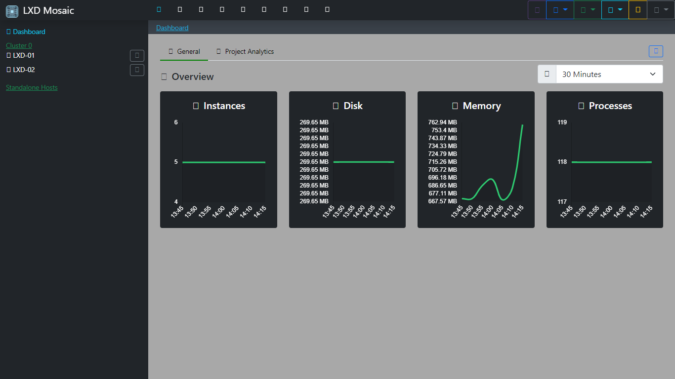

Why is my LXD Mosaic Icon not showing when using nginx domain ?
When I access https://localhost:444 the icon is showing.
I’ve searched on google but couldn’t find a solution.
Please help, thanks.
