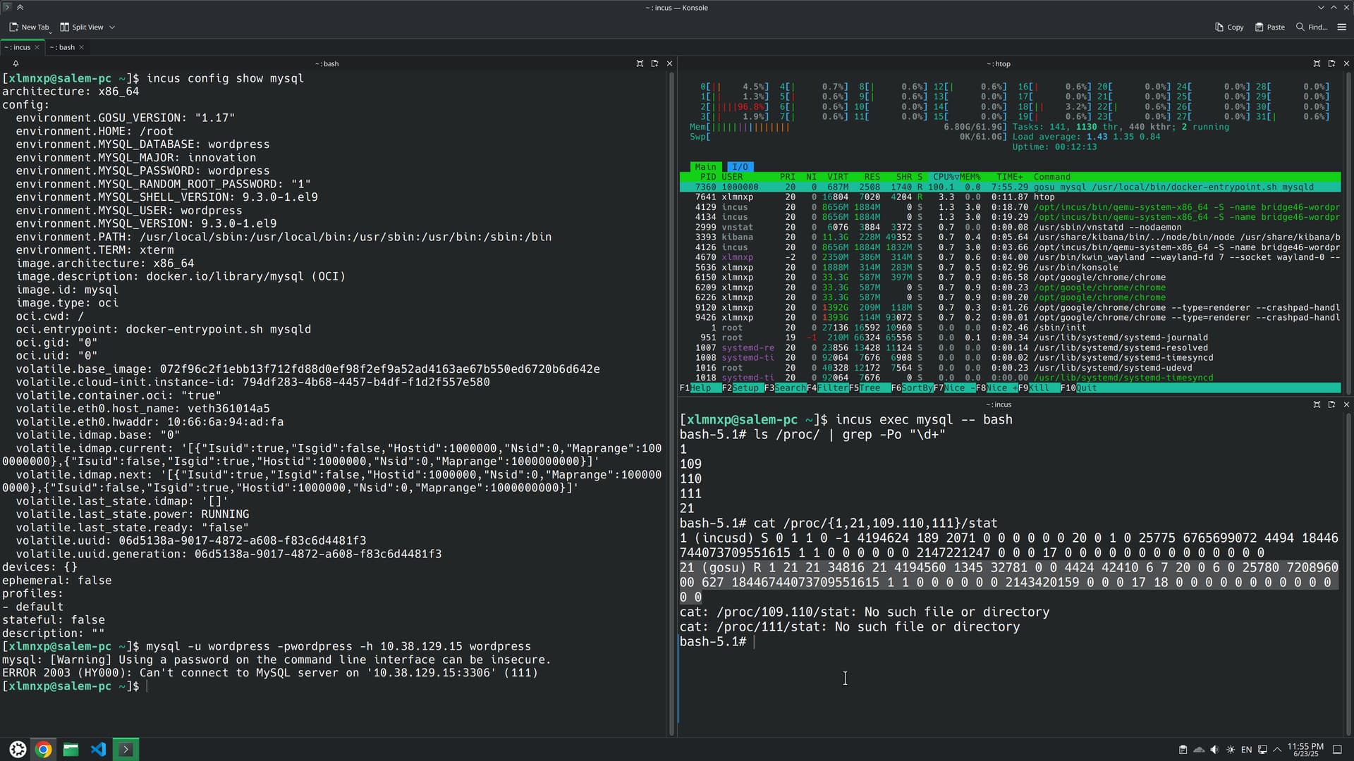

$ htop
Notice: I was facing it before Incus 6.13 and I upgraded to latest version and still facing same issue
I can only spitball guesses as I don’t use MySQL nor its OCI image, but it looks like the docker-entrypoint.sh script executed by gosu does start MySQL.
It also looks like you aren’t creating a proxy device to allow connections.

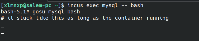

the service stuck at gosu execution as show by the logs
$ incus start mysql --console
To detach from the console, press: <ctrl>+a q
2025-06-25 05:03:08+00:00 [Note] [Entrypoint]: Switching to dedicated user 'mysql'
you will notice docker-entrypoint.sh is using gosu to change user

I tried to test gosu with bash and it stuck too
I have workaround by changing container UID but that will not resolve gosu issue
