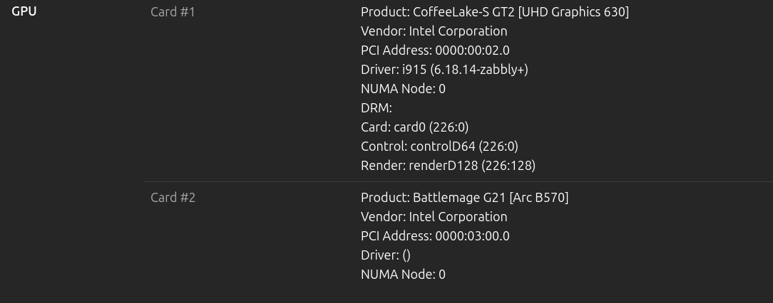

I just installed IncusOS on an “old” desktop. Everything is working great except my external GPU. The Web UI is reporting that no driver has been found for the GPU:
I tried checking the update, rebooting, and so on, but the status remains unchanged.
I’m not sure why this would not work, as Xe driver support was added recently: Add CA certificates documentation, fix smartctl typo and add xe driver support by stgraber · Pull Request #892 · lxc/incus-os · GitHub
However, I had some issues with my motherboard during the installation (constantly trying to re-enable CSM), so I had to remove the external GPU to have a successful installation (with the iGPU). Could it be related to that removal during the installation, or is every driver (amdgpu, xe, nvidia, etc.) present at all times?
Thanks in advance for your help.
Did you install the gpu-support application?
