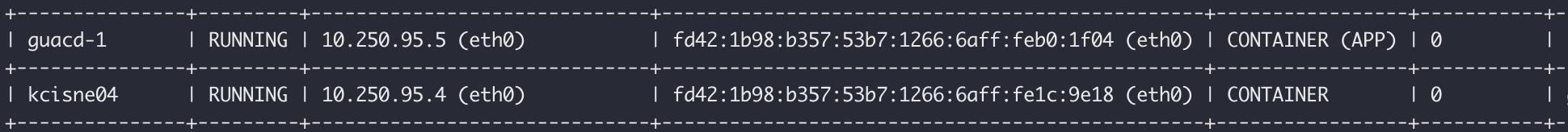

So im trying to run guacd (from guacamole/guacd) in my cluster network and i have the app running with an address it gets from the OVN backend. I have noticed in the past that for some reason i cant ping the other containers on the same ovn network if they are running as the docker version.
Meaning that if I try to run ping kcisne04 from guacd-1 , it simply wont work and it says ping: bad address , I also cant ping guacd-1 from kcisne04 by hostname. But, if i create kcisne04-2 , i have no issues running ping from either container to eachother (i.e i can run ping kcisne04 from kcisne04-2 without issue and vice-versa)…
the docker container can ping websites (i.e google.com) or it can ping other containers if i provide their IP address. I would like to not have to provide the IP address, and im curious if theres anything i can do to fix this ?

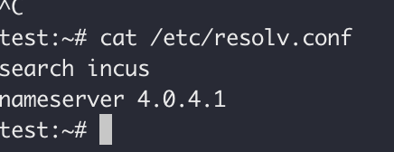

What do you have in /etc/resolv.conf inside the container?
Do you get the same behavior if you ping kcisne04.incus instead of kcisne04?
@stgraber i get the same behavior if i ping .incus at the end too.
My resolv.conf has …
nameserver 1.1.1.1

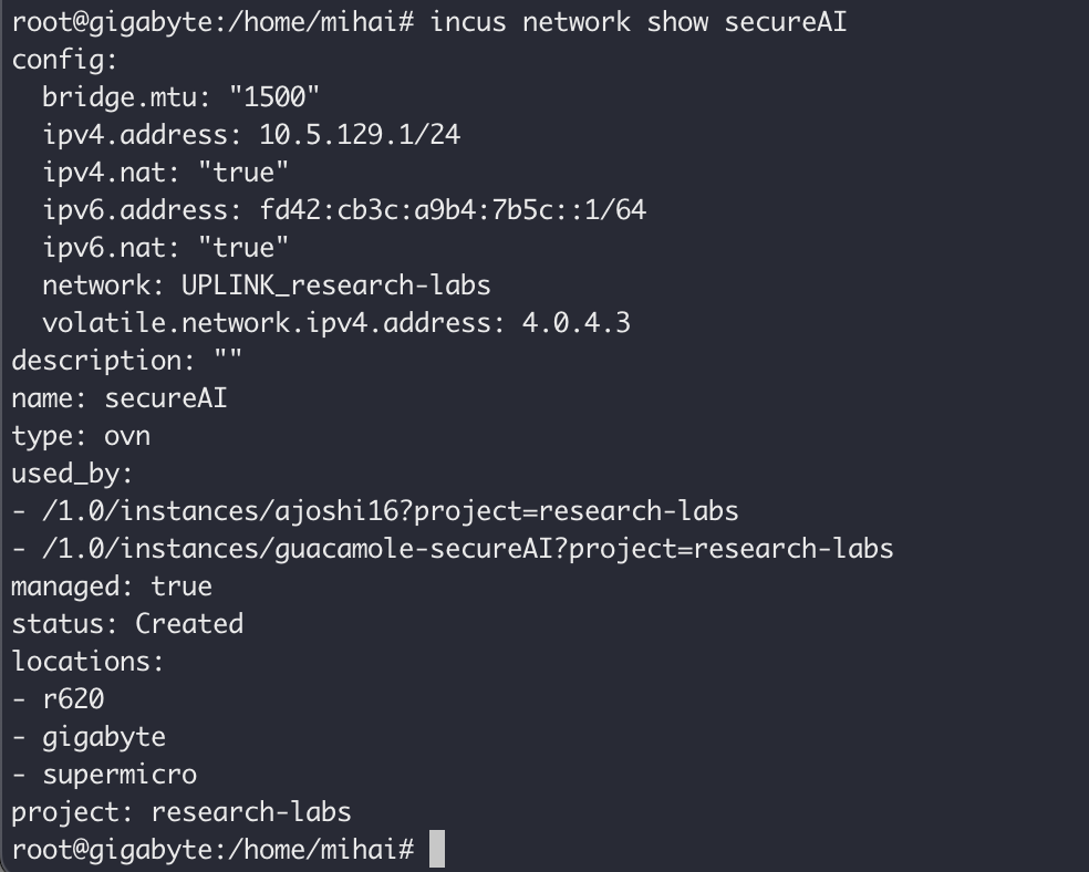

here is my network that i made from the uplink..

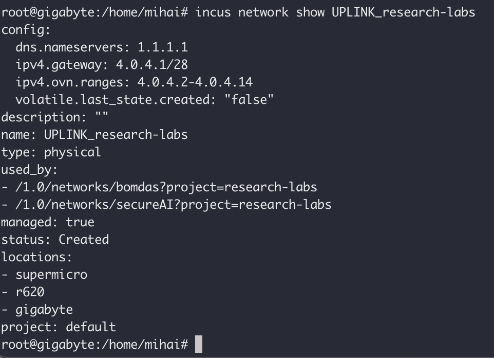

And here is my UPLINK for that network…
Whats odd is that i do have 1.1.1.1 as dns on the uplink, but it works find for my other containers…

so interestingly i took our dns.nameserver from the ovn network and just left it on the uplink…
my UPLINK looks like this…
  dns.nameservers: 4.0.4.1
  ipv4.gateway: 4.0.4.1/28
  ipv4.ovn.ranges: 4.0.4.2-4.0.4.14
  volatile.last_state.created: "false"
type: physical
used_by:
- /1.0/networks/secureAI?project=research-labs
- /1.0/networks/bomdas?project=research-labs
managed: true
status: Created
locations:
- supermicro
- r620
- gigabyte
project: default
and my ovn network created from the uplink as a parent looks like this…
  bridge.mtu: "1500"
  ipv4.address: 10.5.129.1/24
  ipv4.nat: "true"
  ipv6.address: fd42:cb3c:a9b4:7b5c::1/64
  ipv6.nat: "true"
  network: UPLINK_research-labs
  volatile.network.ipv4.address: 4.0.4.3
type: ovn
used_by:
- /1.0/instances/ajoshi16?project=research-labs
- /1.0/instances/caring-wasp?project=research-labs
- /1.0/instances/guacamole-secureAI?project=research-labs
- /1.0/instances/test?project=research-labs
managed: true
status: Created
locations:
- gigabyte
- supermicro
- r620
project: research-labs
buttt i dont have any outside wan connectivity… I can ping internally though.
