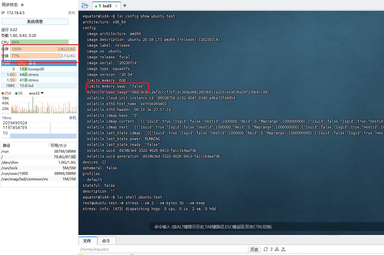

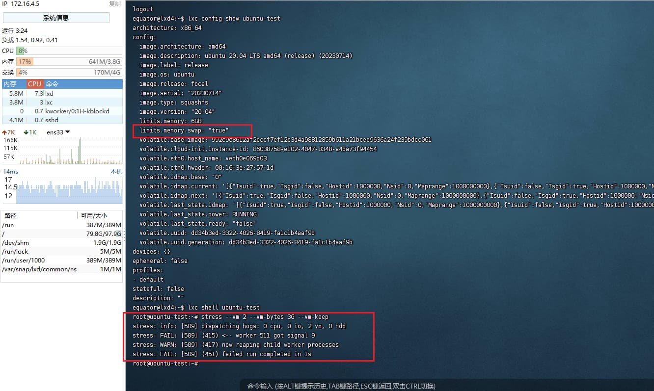

I added the swap space on the host and set “limits.memory.swap=true” for my test containers.
I then tried to allocate more memory than my test container had available, but the process was killed! Swap did not work!
Then I set “limits.memory.swap=false” again, tried the same thing, but now the containers are correctly using swap space and the test processes are NOT being killed. Parts of the process is being moved to swap, even though I set swap to false.

limits.memory always control the total memory usage (RAM+swap).
limits.memory.swap is true by default so setting it to true did nothing in your case.
Setting limits.memory.swap to false turns the swappiness to the absolute minimum to try to force the container to run entirely in RAM with no swap usage.
