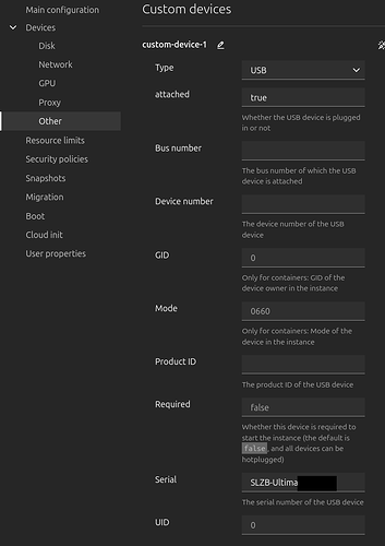

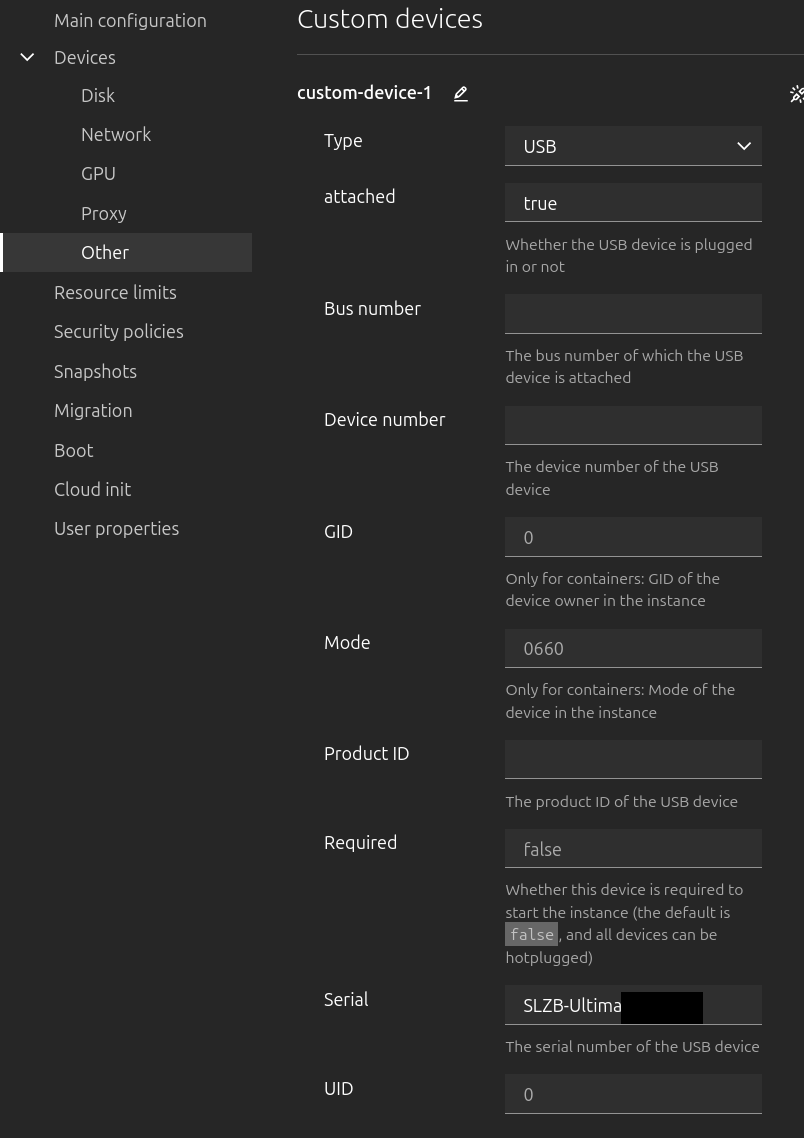

  3. Then configure a “device” in IncusUI (“Devices” → “Other”). You obviously want to choose USB devices:
    This can be checked/is equivalent to:
    $ incus config show IncusOS:HAOS
      custom-device-1:
        attached: "true"
        serial: SLZB-Ultima******
        type: usb
    (Yeah, I also wonder why attached is a string type, but hmm?)

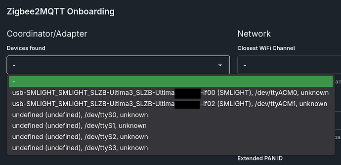

  5. The documentation explains how to then configure it or you can use the onboarding web UI in HomeAssistant.
Thus, I just used the UI this time (also tried with YAML, did not make a difference):

Error for #0
If I select it to configure with /dev/ttyACM0, it cannot even connect:

But I also guess this is the wrong device/“port” aka it’s the “Zigbee router” instead of “Zigbee Coordinator” (I guess, or reverse?). So I just checked this for completeness.
Error for #1
If I choose the /dev/ttyACM1 device, I get weird PAN-ID errors:

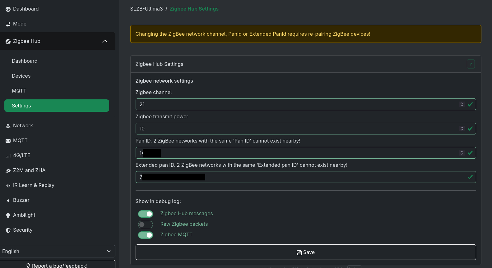

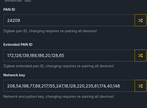

Note I already tried these buttons to re-generate the IDs (so they should be random):
I found this thread but it also just seems to be about re-generating random IDs.
This is a new Zigbee network, so I do not have nor should need a migration or existing network/pan IDs.

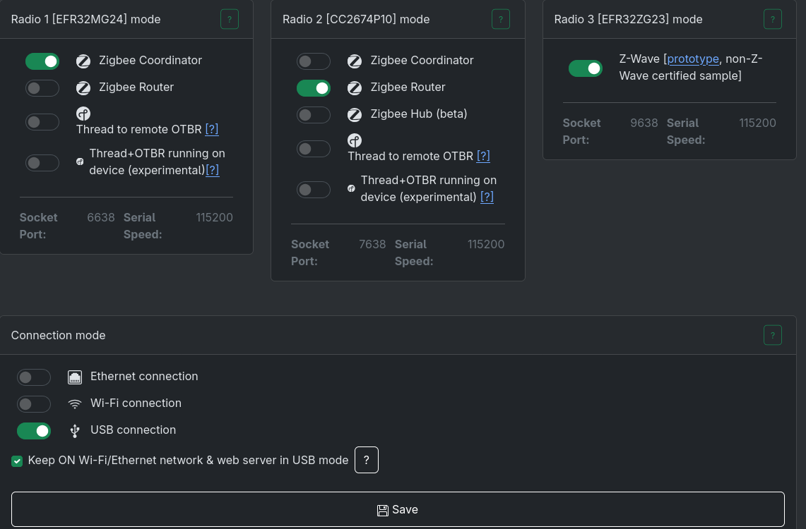

Note I tried around with the SLZB and set the second chip to “Hub mode”, but yeah… just for basic functionality tests, as I want to integrate it into Home Assistant

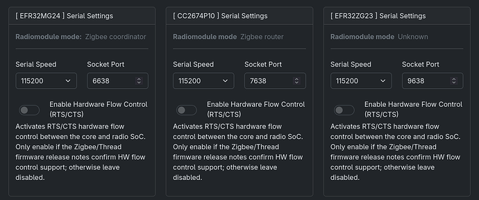

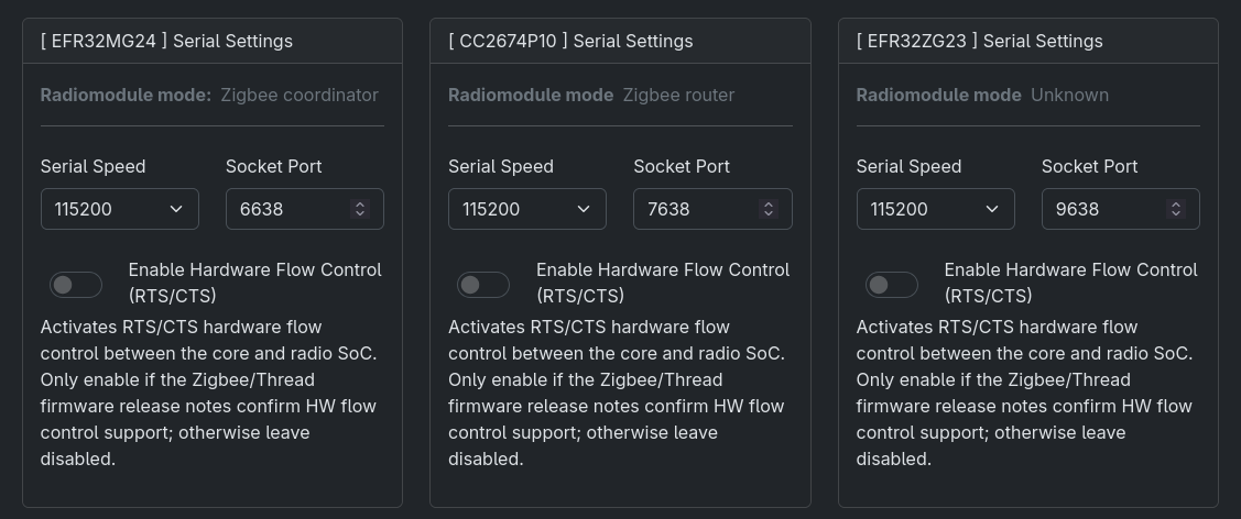

SLZB configuration
To my knowledge, this should be the correct configuration for the SLZB:
I also have Zigbee network IDs etc. in /zhub/config (Zigbee Hub → Settings), I am unsure whether these need to be in sync with Zigbee2MQTT? (in contrast to all other hub settings, I can access this one page without hub mode being enabled, so this is kinda confusing)

Radio 1 [EFR32MG24] Mode Zigbee coordinator
Radio 2 [CC2674P10] Mode Zigbee router
Connection mode: USB mode

You can see the device at the end (surprisingly, it reports no serial there. But in the log it has reported it and this also seems to work for identifying and attaching the device, but yeah… (Or is this expected, because the device is now assigned to the VM?)
Hm yeah, that’s why I was asking and pointing out the vendor’s “driver information” and the weird statement that USB-C to USB-C devices/cables may not work.

For the record: The method I described in the initial post for passing through the USB finally worked. The error was not in Incus, it was just my configuration “in the layers above”.
Okay I noticed one thing after trying a bit more: It’s really flaky and sometimes you need to reboot the VM if the device disconnects.
The reasons I can see:
  • It exposes two serial “ports” (I don’t know the exact term) one for each chip the device has: /dev/serial/by-id/usb-SMLIGHT_SMLIGHT_SLZB-Ultima3_SLZB-UltimaSOMEID-ifXX (XX=01 or 02 or so).
    This is also how HomeAssistant respectively Zigbee2Mqtt in the end access the device.
    • And, AFAIK, you have no way of forwarding these serial ports in Incus(OS), at least I did not see a config option. I can only forward the “whole” USB.
  • In IncusOS /ui/os/system/resources I just saw it was once identified under serial.devices, which was the state where it was not properly forwarded.
  • However, after rebooting the VM, this suddenly switched (notice in that case I did not detach the device or did anything to Incus, just rebooted the VM) and suddenly
  • I would have expected the VMs to support “hot-plug” for USB devices, but maybe that is not the case? So just rebooting the VM could help?
