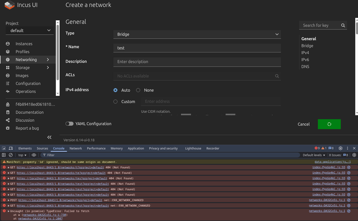

Yes yes, I know, I wouldn’t dispute “it works on my machine” for a second. It does however not do that on my machine. Here’s my screenshot of trying to create the network in the UI, note the spinner on “save” that doesn’t go away. This is “click Create Network” , enter “test”, click “Create”.

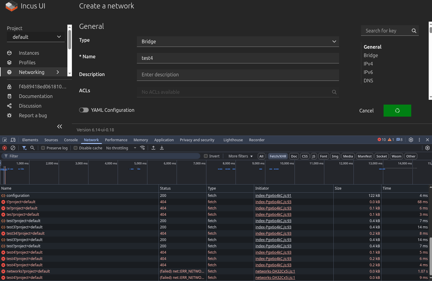

I had a crack at approximating the API output on Chromium (which still doesn’t work);
The full error is “ERR_NETWORK_CHANGED” … which I’ve seen somewhere else recently, it would seem Chromium spits this out sometimes in place of a meaningful error.
