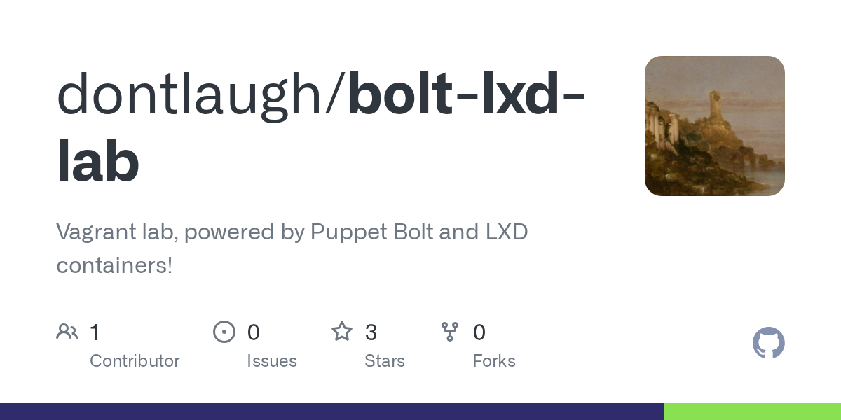

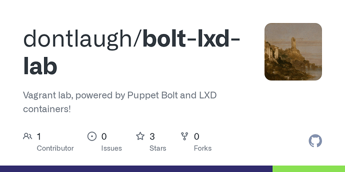

Now that Puppet Bolt has basic support for LXD containers (see Puppet Bolt LXD transport - #12 by dontlaugh), I would like to share a small lab environment I have created.
Install a recent bolt with these instructions Installing Bolt
Then checkout my repo here:
The README and existing files will get you started.
