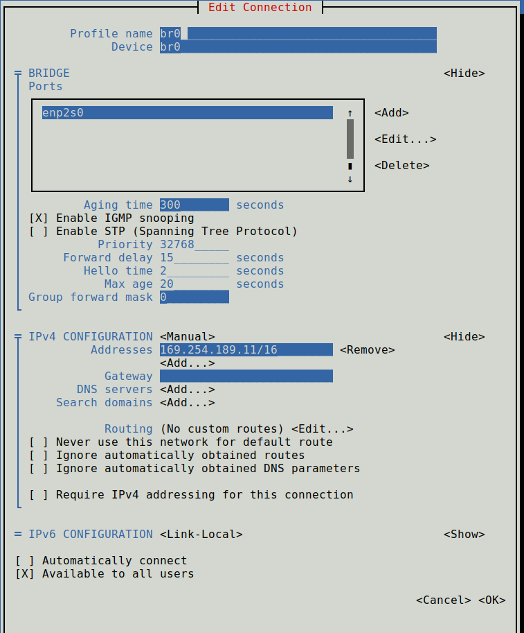

Thanks. I seem to have set up a bridge with NetworkManager, and I think I connected it to Incus correctly, but no IP addresses are being assigned to containers using the bridge. I made sure the firewall is allowing traffic through.
From ip addr:
3: enp2s0: <BROADCAST,MULTICAST,UP,LOWER_UP> mtu 1500 qdisc mq master br0 state UP group default qlen 1000
    link/ether 6c:bf:b5:02:ef:5c brd ff:ff:ff:ff:ff:ff
18: br0: <BROADCAST,MULTICAST,UP,LOWER_UP> mtu 1500 qdisc noqueue state UP group default qlen 1000
    link/ether 22:8c:a8:b2:d5:7d brd ff:ff:ff:ff:ff:ff
    inet 169.254.189.11/16 brd 169.254.255.255 scope global noprefixroute br0
    inet6 fe80::6ebf:b5ff:fe02:ef5c/64 scope link

edit: In face it matters, my router’s subnet is 192.168.50.xxx, not 169.whatever. I’d change that, but last time I did something like that, I lost all network connectivity.
It looks like you go it figured out. Your subnet is not correct.
I would set both IPv4 and IPv6 to Automatic.
Of course, there is always a risk, but your link local address is definitely not going to work.

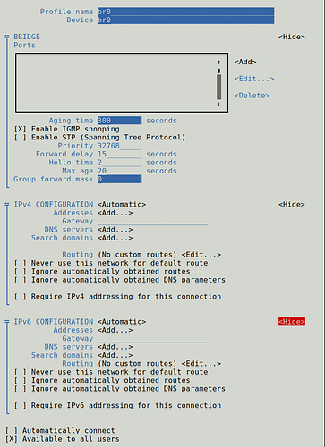

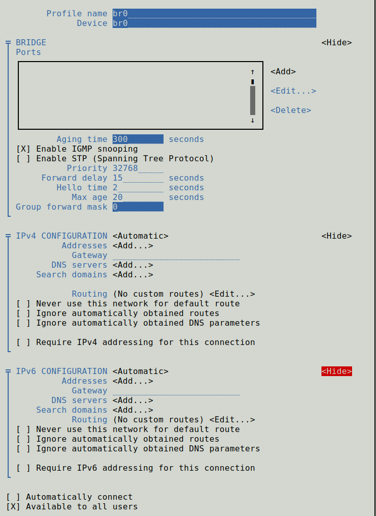

Like this?
I’m still getting
15: br0: <BROADCAST,MULTICAST,UP,LOWER_UP> mtu 1500 qdisc noqueue state UP group default qlen 1000
    link/ether 8a:a2:08:48:b6:c6 brd ff:ff:ff:ff:ff:ff
    inet 169.254.74.210/16 brd 169.254.255.255 scope global noprefixroute br0
I’m the test container using that bridge isn’t receiving any IP addresses (v4 or v6). I tried disabling my firewall, thinking that could be it, but that didn’t help.
So it needs to be 192.168.50.1/24?
I would set it to automatically connect. That is a setting on the bottom.
You will all need to set the network card of your host as a slave for the bridge. My system calls them slaves. It looks like yours might call them ports. You seemed to have that setup before.
The correct subnet should be set automatically. I can’t tell you what it is since I don’t have access to your router.
I hope this works.
