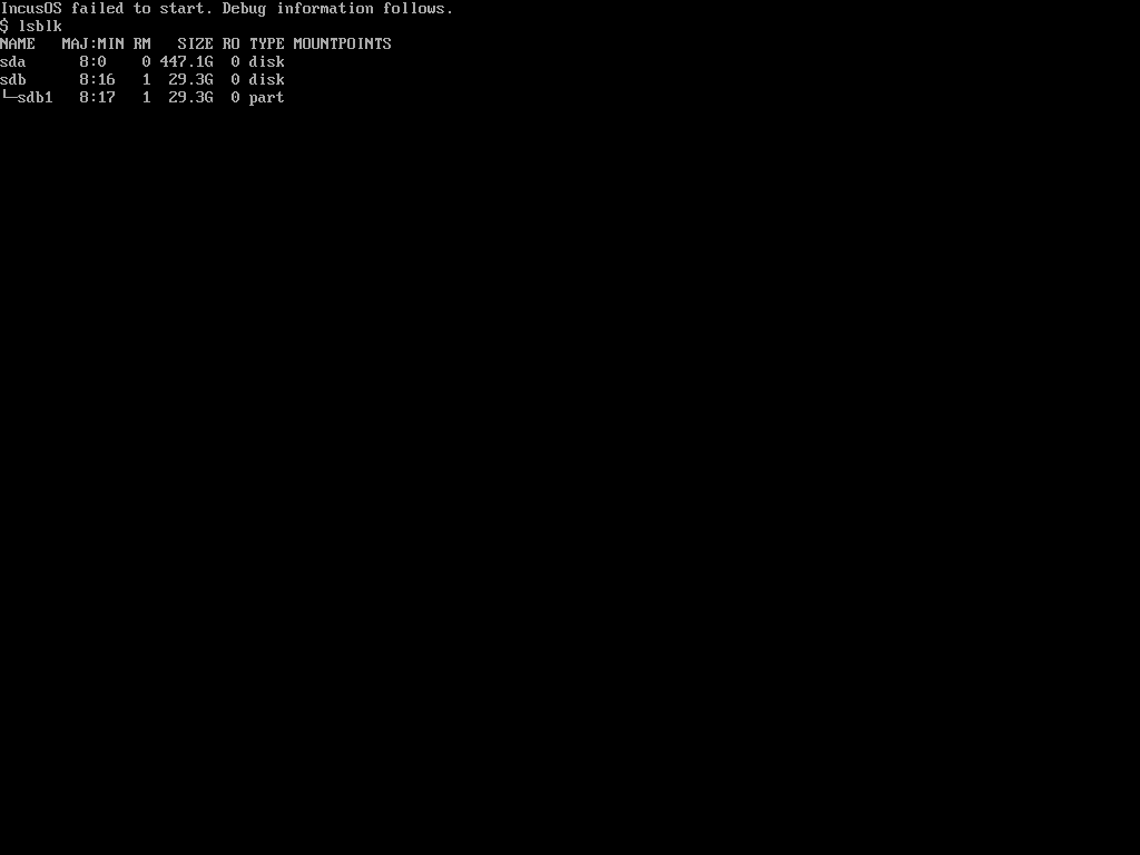

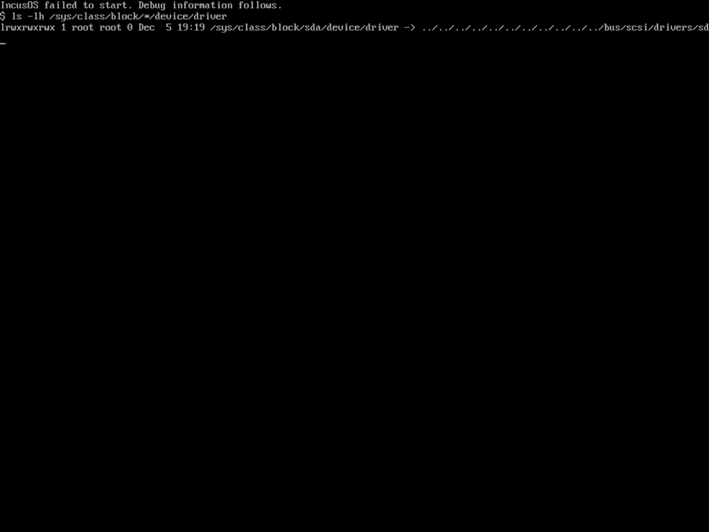

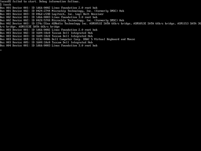

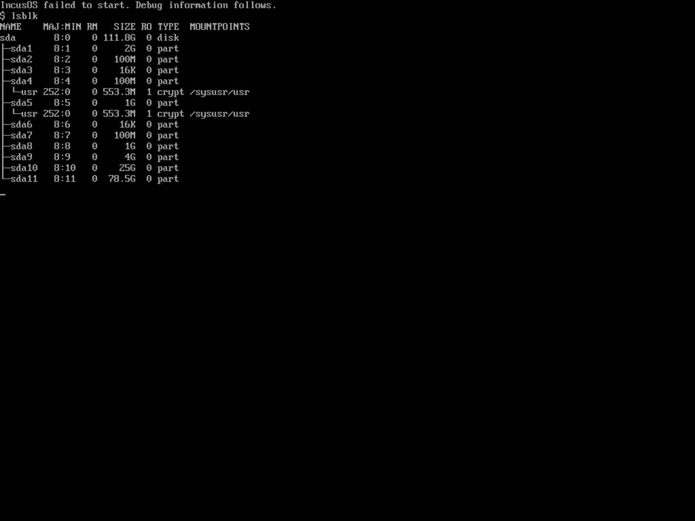

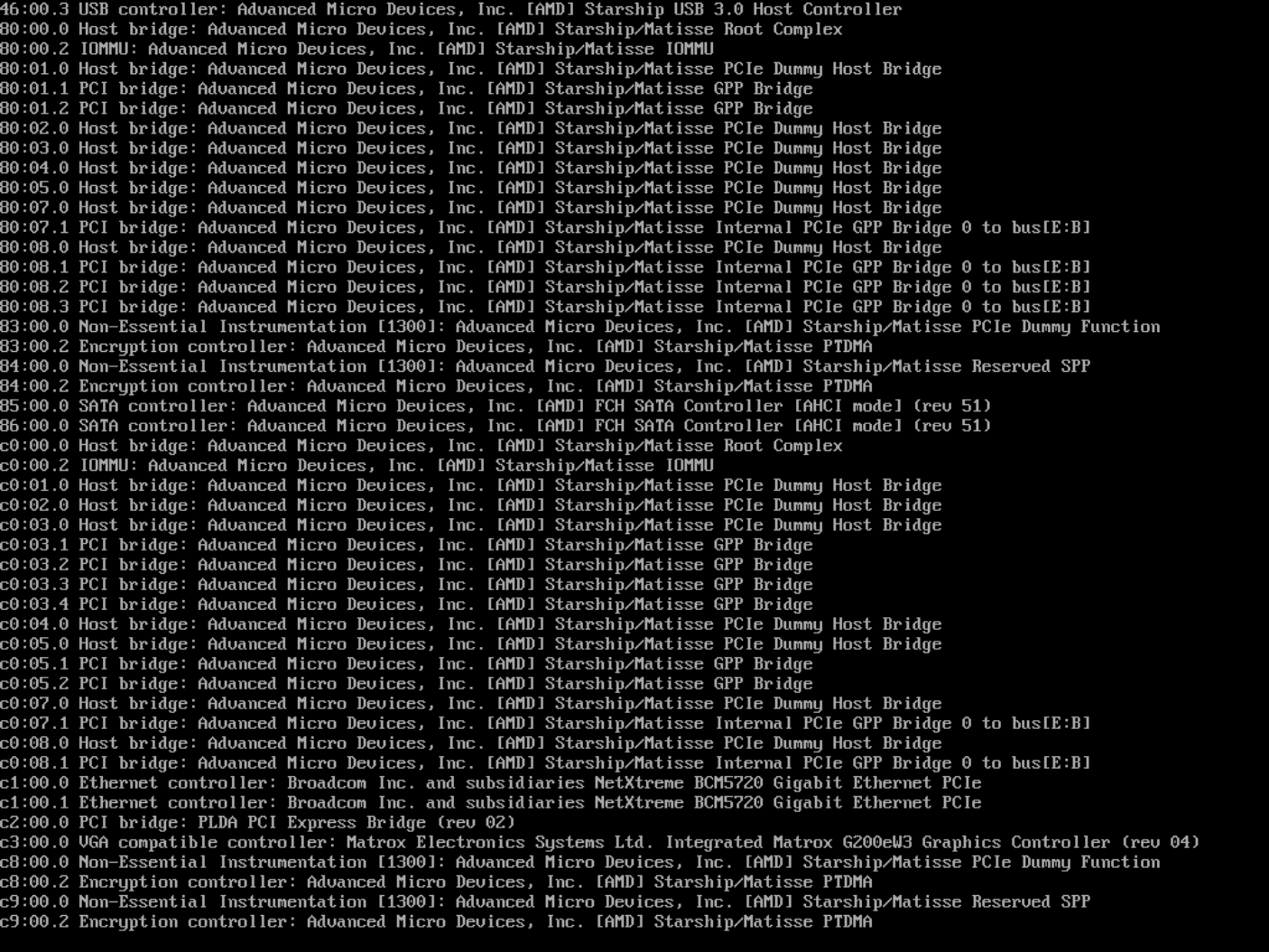

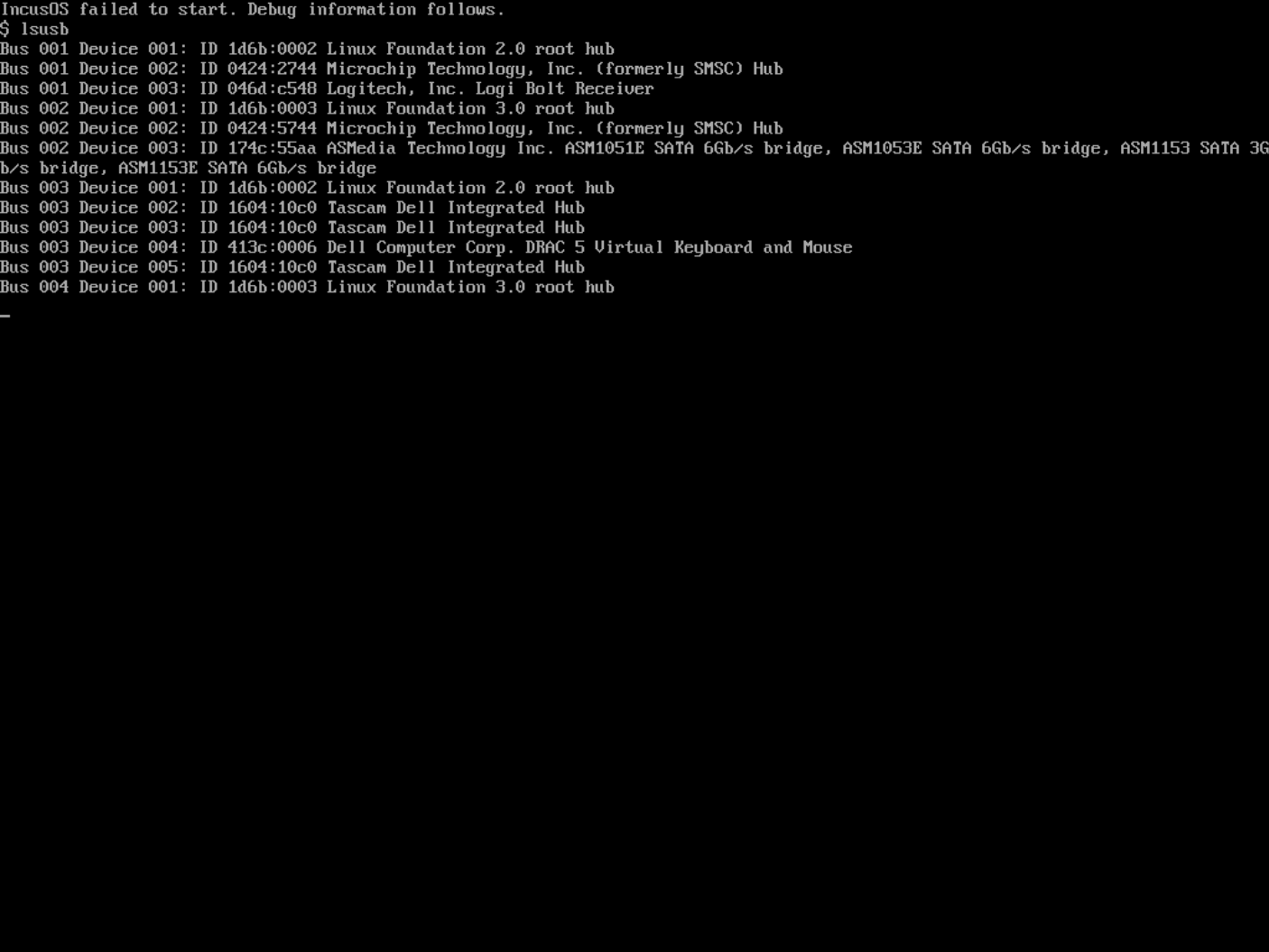

Here are the 4 debug screens. The third screen a bit of information scrolls by.
If i understand correctly, it might be that IncusOS is booted off the USB drive, but then lacks a driver to access the drive itself?

This looks like it should have booted fine to me.
We see a USB SATA controller which leads to a /dev/sda device with what looks like the usual set of partitions on it.
So the storage driver is OK, since we’re clearly getting far enough into the boot process for systemd-repart to create the last three partitions. But I don’t see either swap or the root partition active in the lsblk output, which isn’t a good sign. Typically this will occur if something’s wrong with the state of the TPM that IncusOS expects to see. Since this system is trying to run directly from the USB drive, we haven’t yet been able to run the normal IncusOS pre-start checks which include checking the TPM.

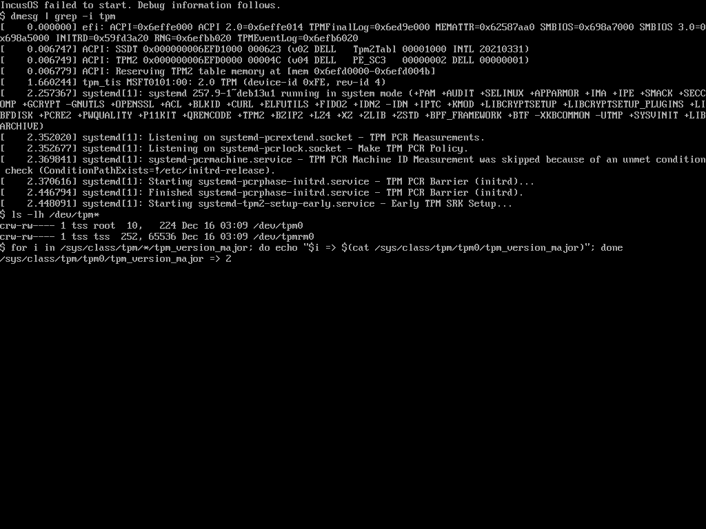

@gibmat should we add something about the TPM to the rotating debug messages?
I could see us having a screen which basically shows:
  • dmesg | grep -i tpm
  • ls -lh /dev/tpm*
  • for i in /sys/class/tpm/*/tpm_version_major; do echo “$i => $(cat $i)”; done
    /sys/class/tpm/tpm0/tpm_version_major => 2
So we can easily check that we do have a TPM and that it’s a 2.0 module.
But what’s odd here is that if it was a TPM issue, repart should have failed to create part10, yet we can clearly see it in the partition list. Unless it does the partition table changes and then fails shortly after when doing the actual formatting?

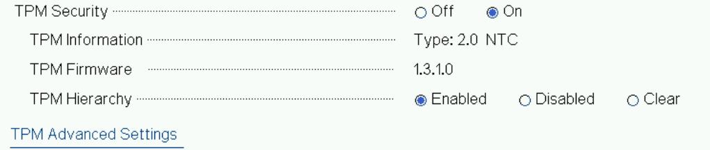

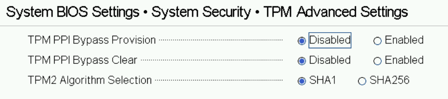

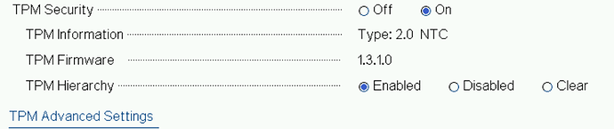

In the meantime, here are the TPM settings in the BIOS. The BIOS is updated to the most current version.
Just now I tried toggling the Algorithm Selection to SHA256 to see if that would change anything. The result is the same.

In addition to failing for some reason when formatting, it’s also possible for it to create the encrypted partitions using weird TPM state that then causes systemd-cryptsetup to fail to decrypt them. But since it works in a VM, I don’t think it’s a general bug. (While playing with swtpm this week I’ve become more familiar than I want with some of the repart/cryptsetup failure modes. :upside_down_face:)
