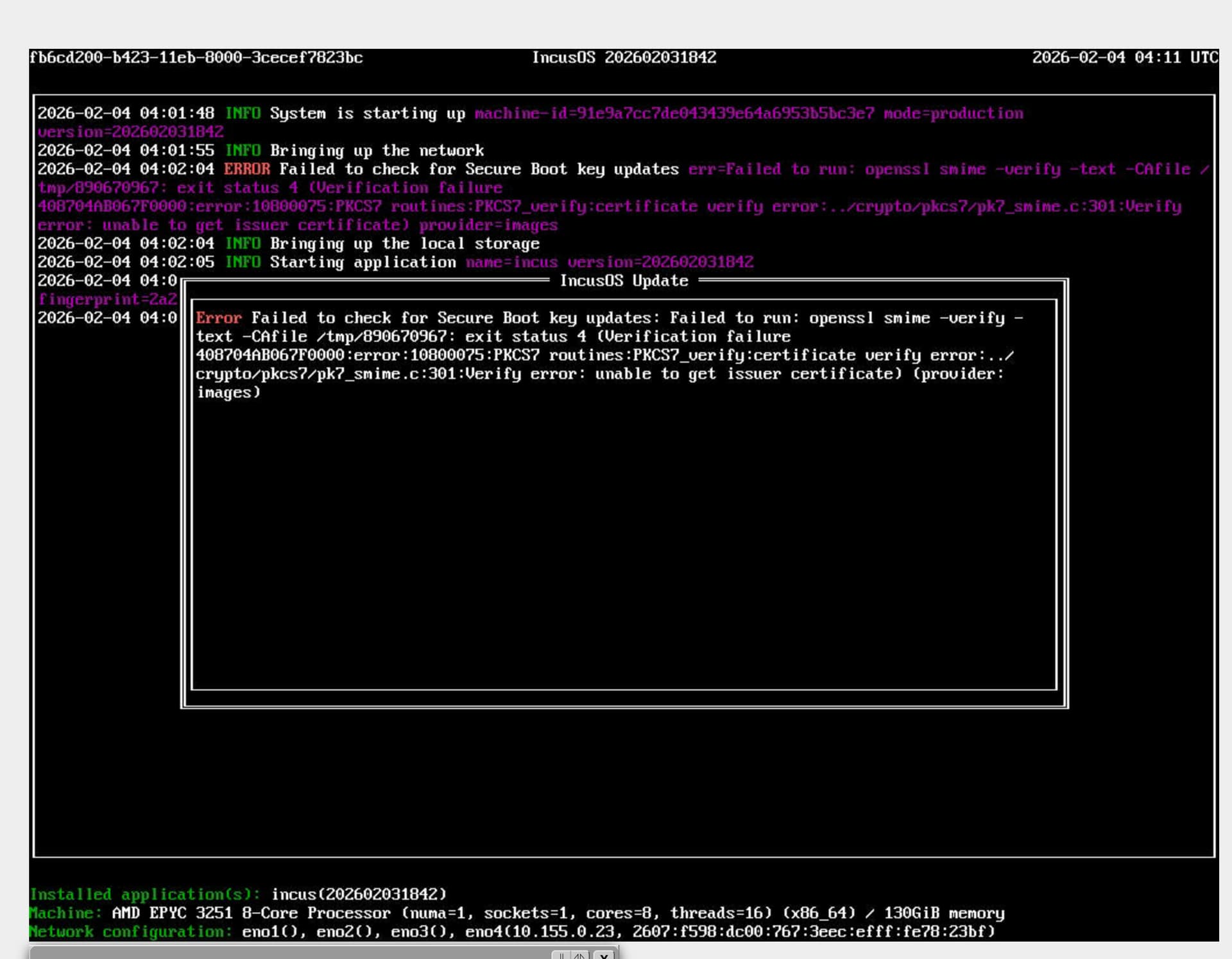

After physically reseating my TPM chip (with the system powered off, as I had to take off the chip to reorganize some cables), IncusOS now fails to check for Secure Boot key updates with the error unable to get issuer certificate.
The system boots and runs normally — TPM auto-unlock works, all containers are running — but every boot shows this verification failure.

  3. Powered the system back on
  4. IncusOS now shows a red error on boot: Verification failure: unable to get issuer certificate

Screenshots
Analysis
It appears the update verification (which uses OpenSSL to validate .auth files against the IncusOS certificate chain) is failing, even though:
  • The UEFI Secure Boot keys (PK, KEK, db) are intact and the system boots fine
  • TPM disk encryption is working correctly
The unable to get issuer certificate error suggests the IncusOS Root CA or intermediate CA certificate used to verify update signatures is missing or inaccessible — possibly due to some internal state being invalidated when the TPM was physically disturbed.

Thanks for the detailed report! I think this is unrelated to having reconnected your TPM; IncusOS 202602031842 includes some changes in how certificates are managed internally and it looks like something’s not quite happy with the CA verification chain.
Most of the development team is traveling back from a meetup today, so it might take a little while before an updated image is published with a fix.
Should be fixed by incus-osd/providers: Use the Root CA to verifiy update metadata by gibmat · Pull Request #869 · lxc/incus-os · GitHub , which we’ll get pushed out as an update ASAP.
Let’s use Bad IncusOS update (202602031842) as the main topic for this one. An update should be available in the next 30min or so, then rebooting onto the previous OS install will download the update for you and should get things back to normal.
