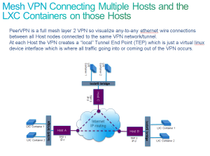

We have built a working overlay L2 network using PeerVPN (https://peervpn.net/). This mesh VPN is deployed over a few bare metal servers running LXD.
We would like containers to see 2 NICs upon creation, the goal being for the container to be able to access both
  • the internet, to expose services to the outside world
  • the VPN, to securely communicate with containers hosted on other LXD servers via PeerVPN.
On each bare metal server, LXD is running the default lxdbr0 bridge in NAT mode, in addition to the tap0 virtual interface managed by PeerVPN. The tap0 interface is allocated a private IP address (192.168.X.X/32) via PeerVPN.

don’t know if you are still looking at this but I’d done this quite a while ago and wrote up a post here but I think the general idea would work the same for LXD as for LXC:
Also have a look at the new Slack Nebula, it seems quite feature rich for building overlays. Also new features coming. Seems similar to peervpn.
If you ran it on every container you could have an overlay stretched to every container and they would be on the same layer2 network.
With regards to two interfaces, if you used nebula, you would end up with eth0 the default interface connecting to the outside world and nebula0 which would be the new interface connected to the overlay.
In the case of something like Zerotier, you would have eth0 as your default interface and an interface called something along the lines of ztks5yas3r as the overlay interface.
No need to bridge any interfaces in the two above cases (nebula / zerotier)
Alternatively look into EVPN, bgp between hosts, vxlan and bridging lxdbr0 to the vxlan1 interface. EVPN is built into Free Range Routing and is basically open source tools, BGP, vxlan etc. Bit more tricky to setup.
