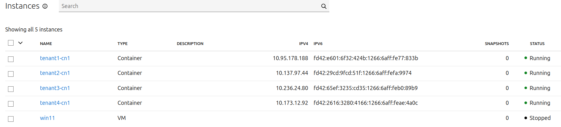

I have the incus ui working locally ok but I’m stumped how to get my local incus ui
to manage remote servers.

But in the Incus UI I don’t see anything about node2 or node3 or the containers each are running?
Shouldn’t the UI see the same as the CLI ?

Whereas the UI only shows the local machine & not anything about the remotes:
Maybe I am misunderstanding what I read but I thought the UI should show what the CLI does after the remotes have been registered
