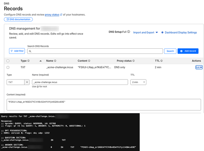

It’s not working. I edit the incus config, put in the values, I see the lego request go out and make the TXT record. I can validate that the TXT record is found with unboundtest.com, but, the validation fails. It says that the record was not found.

Here is the record as it was created in Cloudflare and it is validated in unboundtest.com:
