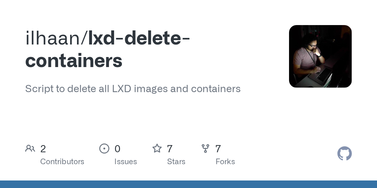

To help with accomplishing what Stephane recommended for completely removing SNAP LXD from a system I found this:
It would seem to accomplish at least the 1st Four steps Stephane recommended?

I’ve not tried this python3 script yet but am setting up a VM that I can install SNAP LXD in, create a bunch of containers with some in the RUN state and others in the STOPPED state and will try it out.
If it works it could be a real time saver if you have dozens or hundreds of containers leaving just steps 5-10 to do?

I created an Ubuntu 18.04 KVM VM and in that created 40 Ubuntu 18.04 LXD containers using SNAP LXD.
I left 1/2 running and 1/2 stopped.
Then I ran iihaan’s lxd-delete-containers python script using the 2 command options:
To Delete all containers: ./delete_all_lxd_containers.py -c
To Delete all images: ./delete_all_lxd_containers.py -i
And in just a minute or two all was deleted.
The only thing I had left to do was steps 7-10.
Which wasn’t as bad as I was thinking it might be.
So it looks like this works okay for a big part of the job of deleting/removing SNAP LXD cleanly.
