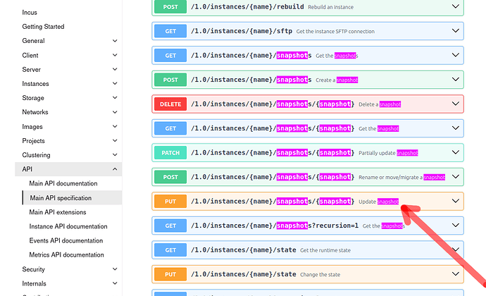

There’s an API for snapshot update that allows to update individual settings of snapshots, such as the expiry. If you were to click in there, the example is about updating the expires_at field.
The first question is whether the existing API is good enough to cover the two cases that you describe above.
If the answer is yes, then the second question is how to expose the API functionality into 1) the incus client, and 2) the Web UI. At least for the incus client it should be relatively easy, just add an incus snapshot update sub-command.
