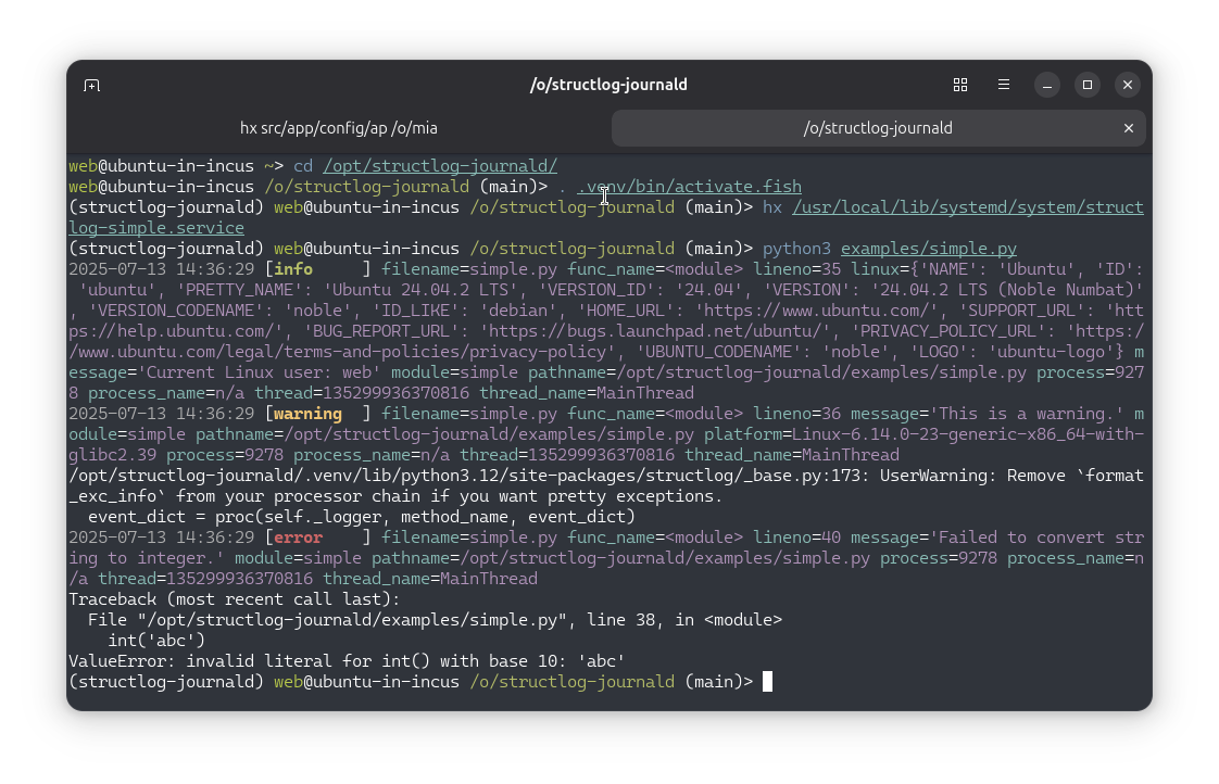

No, it is not interactive. Here is the result when running it outside “systemctl”:
Other than this script, any script run with systemctl start gets the same hanging issue. This issue is not seen when running outside Incus container.
