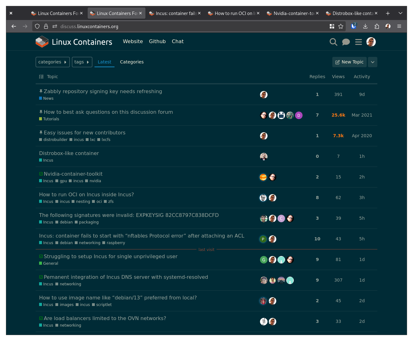

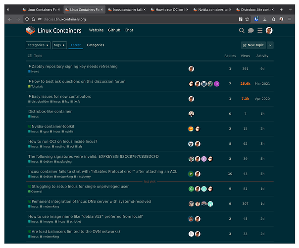

There’s a pinned topic on the forum about it :slight_smile:
Although strangely, the pinning doesn’t seem to be working. If I go to https://discuss.linuxcontainers.org/ I don’t see the thread there.
I remembered I had seen it, but when I came back again I had to search for it.
When you are logged in to the discussion forum, you do not get to see the pinned posts.
In my case it shows the Latest posts, and then only some of the pinned posts. In the last few days I would see the pinned posts for the new releases of Incus, LXC. Are different types of pinned posts?
It may be a user setting of some kind?
Here I see:
Most likely it was this, in the SettingsInterface → Automatically unpin topics when I reach the bottom.
Ι disabled it, but the existing pinned topics do not show. Most likely only newly pinned topics will stay pinned.
