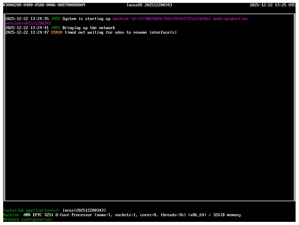

Hi, I’m just wondering what I can do to further diagnose this problem. This is a new install on bare-metal, running off a USB drive. The initial startup went fine, and it was able to update itself.
But after shutting down and starting up again, I am met with this screen. Booting into the previous version also results in the same error: timed out waiting for udev to rename interface(s)

That normally means that an interface MAC address it’s looking for can’t be found.
My gut feeling here is that this machine may have a network interface with a dynamic MAC address, like a virtual network interface used for a BMC.
If that’s left in the network configuration, then you may hit that situation after reboot.
I’d recommend re-installing and when the server is online, go through incus admin os system network edit and make sure that your network configuration only touched the interfaces you actually care about, that should fix the issue of it not finding some interface on boot.

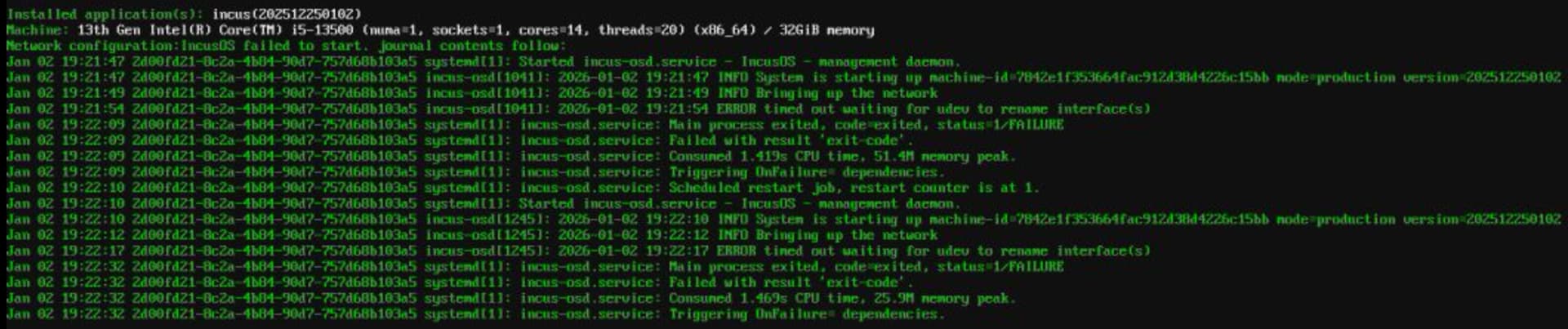

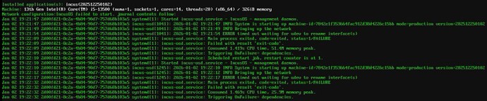

This is the screenshot I created from KVM after the error in OP occurred and the screen blinked just before restarting this procedure.
The only NIC I have is the one on the motherboard (Kontron K3843-B) as far as I can find.

Given you do have your recovery key, it’d be useful for you to boot the system on some kind of live media, then use that to access the encrypted root partition and extract /var/lib/incus-os/state.txt, that should give us a good idea of what MAC addresses it’s looking for and what may be missing.

I’m trying to find /var/lib/incus-os/state.txt but I cannot find it in local/incus. The whole dataset empty from my side after mounting it (mount -t zfs -o ro local/incus /mnt). Am I looking in the wrong direction?
It’s not on ZFS, it’s on the encrypted root partition.
You can find the steps to get access to the LUKS volume in Emergency Procedure for a Lost Client Certificate - IncusOS documentation (obviously ignore the part about messing with certificates as that doesn’t apply to you)
# cat /mnt/incusos/var/lib/incus-os/state.txt
#Version: 6
SecureBoot.Version: 202512250102
SecureBoot.FullyApplied: true
Applications[incus].State.Initialized: true
Applications[incus].State.Version: 202512250102
OS.Name: IncusOS
OS.RunningRelease: 202512250102
OS.SuccessfulBoot: true
System.Network.Config.Time.Timezone: UTC
System.Network.Config.Interfaces[0].Addresses[0]: dhcp4
System.Network.Config.Interfaces[0].Addresses[1]: slaac
System.Network.Config.Interfaces[0].Hwaddr: <my-expected-mac>
System.Network.Config.Interfaces[0].Name: eno1
System.Network.Config.Interfaces[0].RequiredForOnline: no
System.Network.Config.Interfaces[1].Addresses[0]: dhcp4
System.Network.Config.Interfaces[1].Addresses[1]: slaac
System.Network.Config.Interfaces[1].Hwaddr: 82:1a:5f:ee:79:bd
System.Network.Config.Interfaces[1].Name: 821a5fee79bd
System.Network.Config.Interfaces[1].RequiredForOnline: no
System.Provider.Config.Name: images
System.Security.Config.EncryptionRecoveryKeys[0]: <my-recovery-key>
System.Security.State.EncryptionRecoveryKeysRetrieved: true
System.Update.Config.Channel: stable
System.Update.Config.CheckFrequency: 6h
Interfaces[1] is unexpected. How can I get rid of that?
Remove those lines from the state file, that should do the trick.
You’ll want to figure out what that is about though :slight_smile:
Is that on real server hardware? We’ve sometimes seen BMCs expose an internal USB NIC for management/monitoring, those often come without a fixed MAC.
In any case, once it’s out of your state file you should be fine as IncusOS will just ignore any new device that’s not in its config.
But it’s a good reminder to always run incus admin os system network edit after installation to tidy up the network configuration, remove any inferface you don’t actually need and maybe also tweak things like the hostname and interface roles.
I found this in incus admin os system network edit
enxf282a7fef41f:
  hwaddr: f2:82:a7:fe:f4:1f
  mtu: 1500
  state: "off"
  stats:
    rx_bytes: 0
    rx_errors: 0
    tx_bytes: 0
    tx_errors: 0
  type: physical
I’ve got no clue what it corresponds to though :thinking:
Looks like it’s in the state section, so that’s fine. It just shows that your server indeed seems to be getting some kind of virtual USB Ethernet device for some reason and that this device gets a random MAC on every boot…
Ah, I found the initial culprit after all. It’s the virtual network exposed by the NanoKVM: User Guide - Sipeed Wiki. I disabled it to reduce noise.
