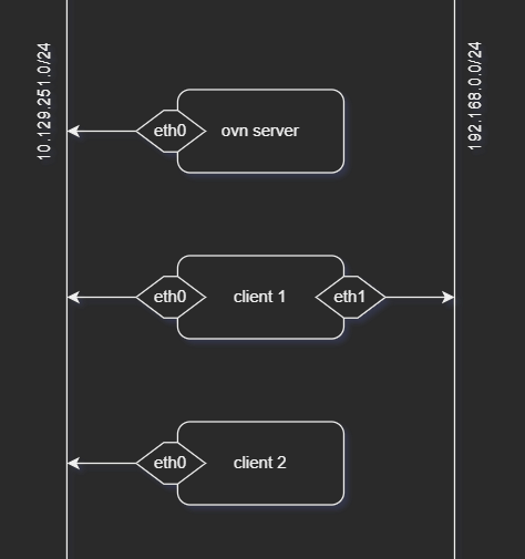

I prepared 4 containers for test, one for ovn server, two for ovn client, one is just a plain host. All of them are debian 13 containers, and connect to same incus managed bridge. Host is debian 13 too.
server is 10.129.251.153. client 1 is 10.129.251.100. client 2 is 10.129.251.91. client 3 is 10.129.251.134.

1-2-1
I restored snapshot. Let’s see localnet port, a type of port connects to “physical” network. I connected client 1 and 3’s eth1 to an ovs bridge not an incus managed bridge. i don’t know why i can’t ping thorugh incus managed bridge use the same method as ovs bridge.
# host
ovs-vsctl add-br br-test
incus config device add <instance> eth1 nic nictype=bridged parent=br-test
# server
ovn-nbctl ls-add ls0
ovn-nbctl lsp-add ls0 ls0-localnet
## localnet port address is always unknown
ovn-nbctl lsp-set-addresses ls0-localnet unknown
ovn-nbctl lsp-set-type ls0-localnet localnet
## you can set network_name to whatever like
ovn-nbctl lsp-set-options ls0-localnet network_name=localnetbind
ovn-nbctl lsp-add ls0 ls0-ins1
ovn-nbctl lsp-set-addresses ls0-ins1 00:00:00:00:00:01
ovn-nbctl lsp-add ls0 ls0-ins2
ovn-nbctl lsp-set-addresses ls0-ins2 00:00:00:00:00:02
# client 1
ovs-vsctl set open_vswitch . external-ids:ovn-remote="tcp:10.129.251.153:6642" external-ids:ovn-encap-ip=10.129.251.100 external-ids:ovn-encap-type=geneve
## another terrible name, what name will you make up
ovs-vsctl add-br br-local
ovs-vsctl add-port br-local eth1
ip link set eth1 up
ovs-vsctl set Open_vSwitch . external-ids:ovn-bridge-mappings=localnetbind:br-local
ovs-vsctl add-port br-int ins1  -- set Interface ins1 type=internal
ovs-vsctl set Interface ins1 external_ids:iface-id=ls0-ins1 mac='["00:00:00:00:00:01"]'
ip addr add 192.168.100.11/24 dev ins1
ip link set ins1 up
# client 2
ovs-vsctl set open_vswitch . external-ids:ovn-remote="tcp:10.129.251.153:6642" external-ids:ovn-encap-ip=10.129.251.91 external-ids:ovn-encap-type=geneve
ovs-vsctl add-port br-int ins2  -- set Interface ins2 type=internal
ovs-vsctl set Interface ins2 external_ids:iface-id=ls0-ins2 mac='["00:00:00:00:00:02"]'
ip addr add 192.168.100.12/24 dev ins2
ip link set ins2 up
# client 3
ip addr add 192.168.100.13/24 dev eth1
ip link set eth1 up

1-2-2
I restored snapshot. Let’s see l2gateway port, another type of port connects to “physical” network but acts as a gateway. Client 1 will be the gateway.
# server
ovn-nbctl lsp-add ls0 ls0-gw
ovn-nbctl lsp-set-type ls0-gw l2gateway
ovn-nbctl lsp-set-addresses ls0-gw unknown
# you can recognize it's client 1's chassis id. I wiil stop joking about my naming sense.
ovn-nbctl lsp-set-options ls0-gw network_name=gatewaybind  l2gateway-chassis=e54ad6e1-382d-4ed7-884e-5e724be3c936
# client 1
ip link set eth1 up
ovs-vsctl set Open_vSwitch . external-ids:ovn-bridge-mappings=gatewaybind:br-local
ip link set ins1 up
# client 2
ip link set ins2 up
# client 3
ip link set eth1 up
ping test
# client 1
~# ping -I ins1 -c 1 192.168.100.12
PING 192.168.100.12 (192.168.100.12) from 192.168.100.11 ins1: 56(84) bytes of data.
64 bytes from 192.168.100.12: icmp_seq=1 ttl=64 time=1.61 ms
--- 192.168.100.12 ping statistics ---
1 packets transmitted, 1 received, 0% packet loss, time 0ms
rtt min/avg/max/mdev = 1.606/1.606/1.606/0.000 ms
~# ping -I ins1 -c 1 192.168.100.13
PING 192.168.100.13 (192.168.100.13) from 192.168.100.11 ins1: 56(84) bytes of data.
64 bytes from 192.168.100.13: icmp_seq=1 ttl=64 time=1.32 ms
--- 192.168.100.13 ping statistics ---
rtt min/avg/max/mdev = 1.320/1.320/1.320/0.000 ms
# client 2
~# ping -I ins2 -c 1 192.168.100.11
PING 192.168.100.11 (192.168.100.11) from 192.168.100.12 ins2: 56(84) bytes of data.
64 bytes from 192.168.100.11: icmp_seq=1 ttl=64 time=0.878 ms
--- 192.168.100.11 ping statistics ---
rtt min/avg/max/mdev = 0.878/0.878/0.878/0.000 ms
~# ping -I ins2 -c 1 192.168.100.13
PING 192.168.100.13 (192.168.100.13) from 192.168.100.12 ins2: 56(84) bytes of data.
64 bytes from 192.168.100.13: icmp_seq=1 ttl=64 time=2.59 ms
rtt min/avg/max/mdev = 2.585/2.585/2.585/0.000 ms
# client 3
~# ping -I eth1 -c 1 192.168.100.11
PING 192.168.100.11 (192.168.100.11) from 192.168.100.13 eth1: 56(84) bytes of data.
64 bytes from 192.168.100.11: icmp_seq=1 ttl=64 time=0.921 ms
rtt min/avg/max/mdev = 0.921/0.921/0.921/0.000 ms
~#  ping -I eth1 -c 1 192.168.100.12
PING 192.168.100.12 (192.168.100.12) from 192.168.100.13 eth1: 56(84) bytes of data.
rtt min/avg/max/mdev = 1.607/1.607/1.607/0.000 ms
Compare to localnet, in server, port type changed to l2gateway and bind to a chassis, in client 1, only changed network name which doesn’t need to change, apart from this, nothing need to change. Ins1 and ins2 and client 3’s eth1 can ping each other. Because l2gateway is a gateway, so ins2 can travel through geneve tunnel to ls0-gw(client 1’s eth1) to ping the other side of gateway.

As you know in 1-2-1, I created a ovs bridge which doesn’t connect to any “physic” port, hence it’s just a “logical” switch. Well, I just plugged it to my router, now, it’s a “physical” switch. It’s time for routing between an overlay logical switch and a bridged logical switch and doing nat. I restored snapshot.
# server
ovn-nbctl lr-add lr0
# I pick a free ip from my lan: 192.168.0.36, you should use your own
ovn-nbctl lrp-add lr0 lr0-to-ls1 00:00:00:00:00:03 192.168.0.36/24
ovn-nbctl ls-add ls1
ovn-nbctl lsp-add ls1 ls1-to-lr0
ovn-nbctl lsp-set-type ls1-to-lr0 router
ovn-nbctl lsp-set-addresses ls1-to-lr0 00:00:00:00:00:03
ovn-nbctl lsp-set-options ls1-to-lr0 router-port=lr0-to-ls1
ovn-nbctl lsp-add ls1 ls1-localnet
ovn-nbctl lsp-set-addresses ls1-localnet unknown
ovn-nbctl lsp-set-type ls1-localnet localnet
ovn-nbctl lsp-set-options ls1-localnet network_name=localnetbind
ovn-nbctl lrp-add lr0 lr0-to-ls2 00:00:00:00:00:04 192.168.200.1/24
ovn-nbctl ls-add ls2
ovn-nbctl lsp-add ls2 ls2-to-lr0
ovn-nbctl lsp-set-type ls2-to-lr0 router
ovn-nbctl lsp-set-addresses ls2-to-lr0  00:00:00:00:00:04
ovn-nbctl lsp-set-options ls2-to-lr0 router-port=lr0-to-ls2
ovn-nbctl lsp-add ls2 ls2-ins2
ovn-nbctl lsp-set-addresses ls2-ins2 "00:00:00:00:00:02 192.168.200.22"
# bind lr0 to client 1 then it's a gateway router
ovn-nbctl set Logical_Router lr0 options:chassis=e54ad6e1-382d-4ed7-884e-5e724be3c936
# 192.168.0.1 is my router ip, you should use your own. it's the static route to internet
ovn-nbctl lr-route-add lr0 "0.0.0.0/0" 192.168.0.1
# there are 3 type of nat: dnat, dnat_and_snat, snat. I prefer snat. Incus prefers dnat_and_snat. Dnat will eat up your ipv4 address pool very fast.
# as you can see this is 2 commands writen as 1. I copyed it, I don't know how to break it apart.
ovn-nbctl -- --id=@nat create nat type="snat" logical_ip=192.168.200.0/24 external_ip=192.168.0.36 -- add logical_router lr0 nat @nat
# client 1
ip link set eth1 up
# client 2
ovs-vsctl set Interface ins2 external_ids:iface-id=ls2-ins2 mac='["00:00:00:00:00:02"]'
ip addr add 192.168.200.22/24 dev ins2

Just a reminder, client 1 is still attached to br-test. And you know client 2 is not attaching to br-test, so no localnet, so no connection, so no need to use it. And I deleted client 3. As always, I restored snapshot, and I will skip install and config incus and create instance part.

2-2-2
1-2-2 + 2-1-1 = 2-2-2
Another reminder, client 2 is not attached to br-test. I restored snapshot, you can think the snapshot has incus installed and configed and an instance created.

2-2-3
There is no 2-2-3, this is a placeholder. If you read 1-2-3, you know vtep port in not in ovn-host but in openvswitch-vtep. But if you know how to let incus works with vtep port, leave a comment.
2-2-4
1-2-4 + 2-1-1 = 2-2-4
I restored snapshot. It’s exactly like 1-2-4 except no external port.

2-3-2
1-3-2 + 2-1-1 = 2-3-2
Just continue to add ls5 as bridged logical switch.
# server
ovn-nbctl lrp-add lr0 lr0-to-ls5 00:00:00:00:05:36 192.168.0.36/24
ovn-nbctl ls-add ls5
ovn-nbctl lsp-add ls5 ls5-to-lr0
ovn-nbctl lsp-set-type ls5-to-lr0 router
ovn-nbctl lsp-set-addresses ls5-to-lr0 00:00:00:00:05:36
ovn-nbctl lsp-set-options ls5-to-lr0 router-port=lr0-to-ls5
ovn-nbctl lsp-add ls5 ls5-localnet
ovn-nbctl lsp-set-addresses ls5-localnet unknown
ovn-nbctl lsp-set-type ls5-localnet localnet
ovn-nbctl lsp-set-options ls5-localnet network_name=localnetbind
ovn-nbctl -- --id=@nat create nat type="snat" logical_ip=192.168.10.0/24 external_ip=192.168.0.36 -- add logical_router lr0 nat @nat
ovn-nbctl -- --id=@nat create nat type="snat" logical_ip=192.168.20.0/24 external_ip=192.168.0.36 -- add logical_router lr0 nat @nat
ovn-nbctl -- --id=@nat create nat type="snat" logical_ip=192.168.30.0/24 external_ip=192.168.0.36 -- add logical_router lr0 nat @nat
ovn-nbctl -- --id=@nat create nat type="snat" logical_ip=192.168.40.0/24 external_ip=192.168.0.36 -- add logical_router lr0 nat @nat
# client 1
ip link set eth1 up
ping test

result
# server
~# ovn-sbctl show
Chassis "e54ad6e1-382d-4ed7-884e-5e724be3c936"
    hostname: oc1
    Encap geneve
        ip: "10.129.251.100"
        options: {csum="true"}
    Port_Binding lr0-to-ls2
    Port_Binding ls2-ins2
    Port_Binding lr0-to-ls3
    Port_Binding ls3-to-lr0
    Port_Binding lr0-to-ls1
    Port_Binding lr0-to-ls4
    Port_Binding ls1-to-lr0
    Port_Binding ls1-ins1
    Port_Binding ls4-to-lr0
    Port_Binding lr0-to-ls5
    Port_Binding ls5-to-lr0
    Port_Binding ls2-to-lr0
Chassis "7225b2eb-68a1-448b-925e-65a83a604b3d"
    hostname: oc2
    Encap geneve
        ip: "10.129.251.91"
    Port_Binding ls4-ins4
    Port_Binding ls3-ins3
~# ovn-nbctl show
switch 2fe7a99c-241b-42a6-be23-3fc13b5fb1d5 (ls4)
    port ls4-to-lr0
        type: router
        addresses: ["00:00:00:00:40:01"]
        router-port: lr0-to-ls4
    port ls4-ins4
        addresses: ["00:00:00:00:00:04 192.168.40.44"]
switch 0ee203a1-2e0b-4e46-a580-427a889d682a (ls5)
    port ls5-localnet
        type: localnet
        addresses: ["unknown"]
    port ls5-to-lr0
        type: router
        addresses: ["00:00:00:00:05:36"]
        router-port: lr0-to-ls5
switch 71e9e125-d201-48fd-ba0a-b3c81b9732ef (ls1)
    port ls1-to-lr0
        type: router
        addresses: ["00:00:00:00:10:01"]
        router-port: lr0-to-ls1
    port ls1-ins1
        addresses: ["00:00:00:00:00:01 192.168.10.11"]
switch c2be28ed-8e4e-4396-b56f-35eaa2d74687 (ls3)
    port ls3-ins3
        addresses: ["00:00:00:00:00:03 192.168.30.33"]
    port ls3-to-lr0
        type: router
        addresses: ["00:00:00:00:30:01"]
        router-port: lr0-to-ls3
switch 4460980b-7e17-48a9-92c2-226df48b2315 (ls2)
    port ls2-to-lr0
        type: router
        addresses: ["00:00:00:00:20:01"]
        router-port: lr0-to-ls2
    port ls2-ins2
        addresses: ["00:00:00:00:00:02 192.168.20.22"]
router 3e097703-9a07-4b42-b96a-dd7812615efe (lr0)
    port lr0-to-ls4
        mac: "00:00:00:00:40:01"
        ipv6-lla: "fe80::200:ff:fe00:4001"
        networks: ["192.168.40.1/24"]
    port lr0-to-ls3
        mac: "00:00:00:00:30:01"
        ipv6-lla: "fe80::200:ff:fe00:3001"
        networks: ["192.168.30.1/24"]
    port lr0-to-ls5
        mac: "00:00:00:00:05:36"
        ipv6-lla: "fe80::200:ff:fe00:536"
        networks: ["192.168.0.36/24"]
    port lr0-to-ls1
        mac: "00:00:00:00:10:01"
        ipv6-lla: "fe80::200:ff:fe00:1001"
        networks: ["192.168.10.1/24"]
    port lr0-to-ls2
        mac: "00:00:00:00:20:01"
        ipv6-lla: "fe80::200:ff:fe00:2001"
        networks: ["192.168.20.1/24"]
    nat 00c3c717-c7e3-43be-a598-2611d555a99a
        external ip: "192.168.0.36"
        logical ip: "192.168.30.0/24"
        type: "snat"
    nat 39d68fd7-2d52-46c0-a515-b93880245b75
        logical ip: "192.168.20.0/24"
        type: "snat"
    nat 7d097a14-68b4-4233-972b-59fc7d203e68
        logical ip: "192.168.40.0/24"
        type: "snat"
    nat 891c5ad1-944a-43d6-8f94-e8779bdcf8fc
        logical ip: "192.168.10.0/24"
        type: "snat"
# client 1
~# ovs-vsctl show
e655c3c9-9f7a-42e4-a9bd-8a639a25949e
    Bridge br-local
        Port patch-ls5-localnet-to-br-int
            Interface patch-ls5-localnet-to-br-int
                type: patch
                options: {peer=patch-br-int-to-ls5-localnet}
        Port eth1
            Interface eth1
        Port br-local
            Interface br-local
                type: internal
    Bridge br-int
        fail_mode: secure
        datapath_type: system
        Port veth_ls2-ins2
            Interface veth_ls2-ins2
        Port ovn-7225b2-0
            Interface ovn-7225b2-0
                type: geneve
                options: {csum="true", key=flow, local_ip="10.129.251.100", remote_ip="10.129.251.91"}
        Port br-int
            Interface br-int
                type: internal
        Port veth_ls1-ins1
            Interface veth_ls1-ins1
        Port patch-br-int-to-ls5-localnet
            Interface patch-br-int-to-ls5-localnet
                type: patch
                options: {peer=patch-ls5-localnet-to-br-int}
# client 2
~# ovs-vsctl show
bd70728b-95af-4a9f-9b62-577ffe017df5
    Bridge br-int
        fail_mode: secure
        Port ovn-e54ad6-0
            Interface ovn-e54ad6-0
                type: geneve
                options: {csum="true", key=flow, local_ip="10.129.251.91", remote_ip="10.129.251.100"}
        Port veth_ls3-ins3
            Interface veth_ls3-ins3
        Port br-int
            Interface br-int
                type: internal
        Port veth_ls4-ins4
            Interface veth_ls4-ins4

3-2-1
Incus can create localnet port for us. Then, why do I write this session? Well, incus only creates localnet port for switch that is in the exit side of router, the go to internet side, just like what I have done in 1-3-2. It has no meaning but I’m going to make incus created overlay logical switch to be bridged logical switch. I restored snapshot.
# client 1
incus config set network.ovn.northbound_connection=tcp:10.129.251.153:6641
incus network create c1-o1 --type=ovn ipv6.address=none ipv4.address=none network=none
# server
~# ovn-nbctl show
switch f596dec1-d828-4c1b-84d1-cb412e5a3589 (incus-net2-ls-int)
Look how simple it is.
ovn-nbctl lsp-add incus-net2-ls-int c1-localnet
ovn-nbctl lsp-set-addresses c1-localnet unknown
ovn-nbctl lsp-set-type c1-localnet localnet
ovn-nbctl lsp-set-options c1-localnet network_name=localnetbind
# client 1
ip link set eth1 up
incus config device add t1 eth0 nic network=c1-o1
~# incus list
| NAME |  STATE  | IPV4 | IPV6 |   TYPE    | SNAPSHOTS |
| t1   | RUNNING |      |      | CONTAINER | 0         |
How would it possiable, t1 can’t get ip from DHCP.

Let’s prepare for 3-2-2.
# client 1
incus config device remove t1 eth0
incus network delete c1-o1
3-2-2
I haven’t found incus using l2gateway before. Anyway, I’m going to attach l2gateway port to incus created overlay logical switch.
# client 1
incus network create c1-o2 --type=ovn ipv6.address=none ipv4.address=none network=none

| t1   | RUNNING | 192.168.0.231 (eth0) |      | CONTAINER | 0         |
Ok, let’s join client 2.

As you have seen, it doesn’t matter where the l2gateway port stays, you can create an overlay logical switch just to hold a l2gateway port. That’s all for 3-2.

        addresses: ["10:66:6a:7e:53:a9"]
switch fde0b0d4-5b48-427f-912f-f205d87ab98f (incus-net3-ls-int)
    port net3-to-net1
        type: switch
    port c1-gw
        type: l2gateway
    port incus-net3-instance-1e8474f7-54b4-4758-b752-29664ba4b92a-eth0
        addresses: ["10:66:6a:ed:3f:61"]
# client 1
~# ovs-vsctl show
    Bridge br-int
        fail_mode: secure
        Port br-int
            Interface br-int
                type: internal
        Port veth4e03361d
            Interface veth4e03361d
        Port patch-br-int-to-c1-gw
            Interface patch-br-int-to-c1-gw
                type: patch
                options: {peer=patch-c1-gw-to-br-int}
        Port ovn-7225b2-0
                type: geneve
    Bridge br-local
        Port br-local
            Interface br-local
                type: internal
        Port patch-c1-gw-to-br-int
            Interface patch-c1-gw-to-br-int
                type: patch
                options: {peer=patch-br-int-to-c1-gw}
        Port eth1
            Interface eth1
# client 2
~# ovs-vsctl show
    Bridge br-int
        fail_mode: secure
        Port ovn-e54ad6-0
                type: geneve
        Port br-int
            Interface br-int
                type: internal
        Port veth56c7f314
            Interface veth56c7f314
3-3-1
I restored snapshot. Let’s bridge incus created logical routers.
# client 1
incus network create c1-o1 --type=ovn network=none  ipv6.address=none
# client 2
incus network create c2-o2 --type=ovn network=none ipv6.address=none
# server
~# ovn-nbctl show
switch 3189a510-d56c-4047-aa1f-f8c92901cf93 (incus-net2-ls-int)
    port incus-net2-ls-int-lsp-router
        type: router
        router-port: incus-net2-lr-lrp-int
switch c9631155-ae88-48ff-94b4-86520508736e (incus-net4-ls-int)
    port incus-net4-ls-int-lsp-router
        type: router
        router-port: incus-net4-lr-lrp-int
router af7f5a98-5a17-4bc6-92ee-bd71e03d1faa (incus-net4-lr)
    port incus-net4-lr-lrp-int
        mac: "10:66:6a:f1:d4:0f"
        ipv6-lla: "fe80::1266:6aff:fef1:d40f"
        networks: ["10.110.152.1/24"]
router 21ce30b3-9de5-462a-980d-50023c8049ed (incus-net2-lr)
    port incus-net2-lr-lrp-int
        mac: "10:66:6a:86:9c:02"
        ipv6-lla: "fe80::1266:6aff:fe86:9c02"
        networks: ["10.207.189.1/24"]
ovn-nbctl ls-add bridge
ovn-nbctl lrp-add incus-net2-lr net2-bridge 02:00:00:00:00:01 10.30.0.2/24
ovn-nbctl lsp-add bridge bridge-net2
ovn-nbctl lsp-set-type bridge-net2 router
ovn-nbctl lsp-set-addresses bridge-net2 02:00:00:00:00:01
ovn-nbctl lsp-set-options bridge-net2 router-port=net2-bridge
ovn-nbctl lrp-add incus-net4-lr net4-bridge 04:00:00:00:00:01 10.30.0.4/24
ovn-nbctl lsp-add bridge bridge-net4
ovn-nbctl lsp-set-type bridge-net4 router
ovn-nbctl lsp-set-addresses bridge-net4 04:00:00:00:00:01
ovn-nbctl lsp-set-options bridge-net4 router-port=net4-bridge
ovn-nbctl lr-route-add incus-net2-lr "10.110.152.0/24" 10.30.0.4
ovn-nbctl lr-route-add incus-net4-lr "10.207.189.0/24" 10.30.0.2
# client 1
~# incus list
| t1   | RUNNING | 10.110.152.2 (eth0) |      | CONTAINER | 0         |
# client 2
incus config device add t2 eth0 nic network=c2-o2
~# incus list
| t2   | RUNNING | 10.207.189.2 (eth0) |      | CONTAINER | 0         |
ping test
# client 1
~# incus exec t1 -- ping -c 1 10.207.189.2
PING 10.207.189.2 (10.207.189.2) 56(84) bytes of data.
64 bytes from 10.207.189.2: icmp_seq=1 ttl=62 time=9.92 ms
--- 10.207.189.2 ping statistics ---
rtt min/avg/max/mdev = 9.922/9.922/9.922/0.000 ms
# client 2
~# incus exec t2 -- ping -c 1 10.110.152.2
PING 10.110.152.2 (10.110.152.2) 56(84) bytes of data.
64 bytes from 10.110.152.2: icmp_seq=1 ttl=62 time=1.69 ms
--- 10.110.152.2 ping statistics ---
rtt min/avg/max/mdev = 1.690/1.690/1.690/0.000 ms
Very easy. And thanks to CMS, that’s all for 3-3.
result
# server
~# ovn-sbctl show
    hostname: oc1
    Encap geneve
    Port_Binding incus-net4-instance-1e8474f7-54b4-4758-b752-29664ba4b92a-eth0
    hostname: oc2
    Encap geneve
        ip: "10.129.251.91"
    Port_Binding incus-net2-instance-b009c960-4137-46f9-a3ee-17a880da639a-eth0
~# ovn-nbctl show
    port incus-net2-instance-b009c960-4137-46f9-a3ee-17a880da639a-eth0
        addresses: ["10:66:6a:68:ed:fd dynamic"]
        type: router
    port incus-net4-instance-1e8474f7-54b4-4758-b752-29664ba4b92a-eth0
        addresses: ["10:66:6a:40:e8:77 dynamic"]
        type: router
switch 14127ce6-2d9f-415a-9af0-be41918854ab (bridge)
    port bridge-net4
        type: router
        addresses: ["04:00:00:00:00:01"]
        router-port: net4-bridge
    port bridge-net2
        type: router
        addresses: ["02:00:00:00:00:01"]
        router-port: net2-bridge
    port net4-bridge
        mac: "04:00:00:00:00:01"
        ipv6-lla: "fe80::600:ff:fe00:1"
        networks: ["10.30.0.4/24"]
    port net2-bridge
        mac: "02:00:00:00:00:01"
        ipv6-lla: "fe80::ff:fe00:1"
        networks: ["10.30.0.2/24"]
~# ovn-nbctl lr-route-list incus-net2-lr
IPv4 Routes
Route Table <main>:
          10.110.152.0/24                 10.30.0.4 dst-ip
~# ovn-nbctl lr-route-list incus-net4-lr
IPv4 Routes
Route Table <main>:
          10.207.189.0/24                 10.30.0.2 dst-ip
# client 1
~# ovs-vsctl show
    Bridge br-int
        fail_mode: secure
        Port br-int
            Interface br-int
                type: internal
        Port veth87fe7619
            Interface veth87fe7619
        Port ovn-7225b2-0
                type: geneve
~# incus network show c1-o1
  bridge.mtu: "1442"
  ipv4.address: 10.110.152.1/24
  ipv4.nat: "true"
  ipv6.address: none
  network: none
type: ovn
used_by:
- /1.0/instances/t1
managed: true
status: Created
locations:
- none
project: default
# client 2
~# ovs-vsctl show
    Bridge br-int
        fail_mode: secure
        Port ovn-e54ad6-0
                type: geneve
        Port veth43f0c23e
            Interface veth43f0c23e
        Port br-int
            Interface br-int
                type: internal
~# incus network show c2-o2
  bridge.mtu: "1442"
  ipv4.address: 10.207.189.1/24
  ipv4.nat: "true"
  ipv6.address: none
  network: none
type: ovn
used_by:
- /1.0/instances/t2
managed: true
status: Created
locations:
- none
project: default
3-4-1
Let’s finish this post with one weird example, isolated ovn network for features.networks=true project. I restored snapshot.
# client 1
incus project create p1 --config features.networks=true --config features.networks.zones=true
Normally, you created a network in default project then add it to the limited project, something like:
incus network create incusbr1 ipv4.address=10.129.251.1/24 ipv4.dhcp=true ipv4.dhcp.ranges=10.129.251.10-10.129.251.90 ipv4.nat=true ipv4.ovn.ranges=10.129.251.100-10.129.251.200 ipv6.address=none
incus project set p1 restricted.networks.access=incusbr1
But I’m not going to do it.
~# incus project switch p1
~# incus network list
| NAME | TYPE | MANAGED | IPV4 | IPV6 | DESCRIPTION | USED BY | STATE |
~# incus network create n1
Error: No allowed uplink networks in project
~# incus network create n1 --type=ovn network=none ipv6.address=none
Network n1 created
~# ovs-vsctl add-br br-local
~# ovs-vsctl add-port br-local eth1
~# ip link set eth1 up
~# incus network create n2 --type=ovn network=br-local ipv6.address=none
Error: Option "network" value "br-local" is not one of the allowed uplink networks in project
As you can see, I can’t create a normal incus managed network in limited project, but I can create a rather useless incus managed ovn network.
info
~# incus project show p1
  features.images: "true"
  features.networks: "true"
  features.networks.zones: "true"
  features.profiles: "true"
  features.storage.buckets: "true"
  features.storage.volumes: "true"
used_by:
- /1.0/networks/n1?project=p1
- /1.0/profiles/default?project=p1
~# incus profile show default
  security.privileged: "true"
description: Default Incus profile for project p1
    pool: dirpool
used_by: []
project: p1
~# incus network show n1
  bridge.mtu: "1442"
  ipv4.address: 10.44.114.1/24
  ipv4.nat: "true"
  ipv6.address: none
  network: none
type: ovn
used_by: []
managed: true
status: Created
locations:
- none
project: p1
Thankfully, n1 is an ovn network, I can route it to internet.
# server
~# ovn-nbctl show
switch 328cfc45-d559-46b5-941b-62e26e2ce3cc (incus-net2-ls-int)
        type: router
router 541c2660-2a4e-4039-b638-eafb3764e234 (incus-net2-lr)
        mac: "10:66:6a:49:5e:86"
        ipv6-lla: "fe80::1266:6aff:fe49:5e86"
        networks: ["10.44.114.1/24"]
As you can see incus-net2-ls-int is n1. I’m going to do it like 2-3-2 + 3-3-1.
ovn-nbctl lrp-add lr0 lr0-bridge 06:00:00:00:00:01 10.30.0.6/24
ovn-nbctl lsp-add bridge bridge-lr0
ovn-nbctl lsp-set-type bridge-lr0 router
ovn-nbctl lsp-set-addresses bridge-lr0 06:00:00:00:00:01
ovn-nbctl lsp-set-options bridge-lr0 router-port=lr0-bridge
ovn-nbctl lr-route-add incus-net2-lr "0.0.0.0/0" 10.30.0.6
ovn-nbctl lr-route-add lr0 "10.44.114.0/24" 10.30.0.2
ovn-nbctl -- --id=@nat create nat type="snat" logical_ip=10.44.114.0/24 external_ip=192.168.0.36 -- add logical_router lr0 nat @nat
# client 1
~# ovs-vsctl set Open_vSwitch . external-ids:ovn-bridge-mappings=localnetbind:br-local
~# incus launch images:debian/13 i1 --network n1 --project p1
~# incus list
| i1   | RUNNING | 10.44.114.2 (eth0) |      | CONTAINER | 0         |
ping test
~# incus exec i1 -- ping -c 1 10.44.114.1
PING 10.44.114.1 (10.44.114.1) 56(84) bytes of data.
64 bytes from 10.44.114.1: icmp_seq=1 ttl=254 time=0.824 ms
--- 10.44.114.1 ping statistics ---
rtt min/avg/max/mdev = 0.824/0.824/0.824/0.000 ms
~# incus exec i1 -- ping -c 1 10.30.0.6
PING 10.30.0.6 (10.30.0.6) 56(84) bytes of data.
64 bytes from 10.30.0.6: icmp_seq=1 ttl=253 time=4.31 ms
--- 10.30.0.6 ping statistics ---
rtt min/avg/max/mdev = 4.306/4.306/4.306/0.000 ms
~# incus exec i1 -- ping -c 1 10.30.0.2
PING 10.30.0.2 (10.30.0.2) 56(84) bytes of data.
--- 10.30.0.2 ping statistics ---
1 packets transmitted, 0 received, 100% packet loss, time 0ms
~# incus exec i1 -- ping -c 1 192.168.0.36
PING 192.168.0.36 (192.168.0.36) 56(84) bytes of data.
64 bytes from 192.168.0.36: icmp_seq=1 ttl=253 time=0.835 ms
--- 192.168.0.36 ping statistics ---
rtt min/avg/max/mdev = 0.835/0.835/0.835/0.000 ms
~# incus exec i1 -- ping -c 1 192.168.0.1
PING 192.168.0.1 (192.168.0.1) 56(84) bytes of data.
64 bytes from 192.168.0.1: icmp_seq=1 ttl=62 time=7.05 ms
--- 192.168.0.1 ping statistics ---
rtt min/avg/max/mdev = 7.052/7.052/7.052/0.000 ms
~# incus exec i1 -- ping -c 1 192.168.0.10
PING 192.168.0.10 (192.168.0.10) 56(84) bytes of data.
64 bytes from 192.168.0.10: icmp_seq=1 ttl=62 time=5.80 ms
--- 192.168.0.10 ping statistics ---
rtt min/avg/max/mdev = 5.797/5.797/5.797/0.000 ms
~# incus exec i1 -- ping -c 1 1.1.1.1
PING 1.1.1.1 (1.1.1.1) 56(84) bytes of data.
64 bytes from 1.1.1.1: icmp_seq=1 ttl=51 time=61.1 ms
--- 1.1.1.1 ping statistics ---
rtt min/avg/max/mdev = 61.134/61.134/61.134/0.000 ms
I want ls5 can only to 192.168.0.1 and 192.168.0.36. And I don’t know how to write ACL, so I asked AI, and below commands works:
ovn-nbctl acl-add ls5 from-lport 1002 'ip4 && (ip4.dst == 192.168.0.1 || ip4.dst == 192.168.0.36)' allow
ovn-nbctl acl-add ls5 to-lport 1002 'ip4 && (ip4.src == 192.168.0.1 || ip4.src == 192.168.0.36)' allow
ovn-nbctl acl-add ls5 from-lport 1001 'ip4' drop
ovn-nbctl acl-add ls5 to-lport 1001 'ip4' drop
result
# server
~# ovn-sbctl show
    hostname: oc1
    Encap geneve
    Port_Binding lr0-bridge
    Port_Binding bridge-lr0
    Port_Binding incus-net2-instance-0d472587-f5ab-4814-a236-618a3a74b5ae-eth0
~# ovn-nbctl show
        type: router
    port incus-net2-instance-0d472587-f5ab-4814-a236-618a3a74b5ae-eth0
        addresses: ["10:66:6a:e2:bf:d9 dynamic"]
switch e71aa0e1-4816-463f-b21b-42b75f581e45 (bridge)
    port bridge-lr0
        type: router
        addresses: ["06:00:00:00:00:01"]
        router-port: lr0-bridge
    port bridge-net2
        type: router
switch aa75f581-f0fd-4811-a918-b189d3d2d15c (ls5)
    port ls5-to-lr0
        type: router
    port ls5-localnet
        type: localnet
router 7999c5d0-78bb-4899-bb72-7b0d6b1aef08 (lr0)
    port lr0-bridge
        mac: "06:00:00:00:00:01"
        ipv6-lla: "fe80::400:ff:fe00:1"
        networks: ["10.30.0.6/24"]
    port lr0-to-ls5
    nat e6f38eed-0b46-4d64-9120-01fe78f43cc0
        logical ip: "10.44.114.0/24"
        type: "snat"
    port net2-bridge
~# ovn-nbctl list logical_router
_uuid               : 7999c5d0-78bb-4899-bb72-7b0d6b1aef08
copp                : []
enabled             : []
external_ids        : {}
load_balancer       : []
load_balancer_group : []
nat                 : [e6f38eed-0b46-4d64-9120-01fe78f43cc0]
options             : {chassis="e54ad6e1-382d-4ed7-884e-5e724be3c936"}
policies            : []
ports               : [27bb5441-741b-42f6-8907-32d928a68deb, c670a36b-2417-45fa-933b-4edba4bfd65b]
static_routes       : [0be84100-5507-43d7-9ba7-5697a09c5a60, 461297d8-b771-40cf-b209-d96e3463d4ee]
_uuid               : 541c2660-2a4e-4039-b638-eafb3764e234
copp                : []
enabled             : []
external_ids        : {}
load_balancer       : []
nat                 : []
options             : {always_learn_from_arp_request="false", dynamic_neigh_routers="true"}
policies            : [43236e43-3a6c-43e9-a491-eab78ea7a24a, b2c167a0-595b-4c57-8996-0f4ba9617593, d3b5f2b2-d1c5-4547-b4df-d64fe1ce6da7]
ports               : [02a448d0-49a0-4c28-bb27-913319c9272c, da69f67f-ff6c-43f1-9b63-88214ba7b1df]
static_routes       : [b9a486aa-eb68-4734-b086-e5e591c6ff5a]
~# ovn-nbctl list logical_switch
_uuid               : 328cfc45-d559-46b5-941b-62e26e2ce3cc
acls                : [4b2eebfd-2569-4de1-a080-2e8b06c3d490, 62220b0f-3f9d-4e5a-8278-47aee4e1cc53, 70ca16e0-8dd0-4c5b-b06a-cee3c223d7d9, 7db7c729-e6fd-4f0e-b8e3-01259d1926e4, b0838abe-96a1-4563-948c-75c48384123a, b1af6d28-69a4-4bbf-bef9-13e02973ad94, b46ea373-982a-4d55-b9a7-c301f2bd388f, c7ee2fe4-cc95-4724-82f8-b127564459d7, e497490e-5247-4a37-ba52-d9652b714212, f62a3306-7b7b-4956-b432-fff5f4edb800, f7b426c5-435d-42a5-bcb2-6f3b688cc70e]
copp                : []
dns_records         : [593c79f9-9fc3-48c8-bf40-8116346eab7f]
external_ids        : {}
forwarding_groups   : []
load_balancer       : []
other_config        : {exclude_ips="10.44.114.1 10.44.114.254", subnet="10.44.114.0/24"}
ports               : [9c578c55-4de3-4bcf-b422-c7203c828096, fde02c20-f4c7-445c-a410-89d18c494e91]
qos_rules           : []
_uuid               : e71aa0e1-4816-463f-b21b-42b75f581e45
acls                : []
copp                : []
dns_records         : []
external_ids        : {}
load_balancer       : []
other_config        : {}
ports               : [38bad53f-7eda-4c18-b9c5-d14c4a64f2cf, 4907dc71-ea16-4f71-baa0-560555265118]
qos_rules           : []
_uuid               : aa75f581-f0fd-4811-a918-b189d3d2d15c
acls                : [159a7d15-befa-449c-b86a-d5bf8ffbee09, 4fa10284-30ca-4e48-b640-2d4e14020802, a7c2bfba-fd74-470f-b8be-41735bc001fe, be15f07e-1f36-45c3-8ffd-706e98052ae8]
copp                : []
dns_records         : []
external_ids        : {}
load_balancer       : []
other_config        : {}
ports               : [66a8ce87-8051-4662-bb17-9c7055ed17a8, cdc22c53-a1c8-4c43-99a6-4a922df72d4a]
qos_rules           : []
~# ovn-nbctl list logical_switch_port
_uuid               : fde02c20-f4c7-445c-a410-89d18c494e91
addresses           : ["10:66:6a:e2:bf:d9 dynamic"]
dhcpv4_options      : f50613e7-aca5-48fd-b98f-a03cef867f7b
dhcpv6_options      : []
dynamic_addresses   : "10:66:6a:e2:bf:d9 10.44.114.2"
enabled             : []
external_ids        : {incus_location=none, incus_switch=incus-net2-ls-int}
ha_chassis_group    : []
mirror_rules        : []
options             : {requested-chassis="e54ad6e1-382d-4ed7-884e-5e724be3c936"}
parent_name         : []
peer                : []
port_security       : []
tag                 : []
tag_request         : []
type                : ""
up                  : true
_uuid               : 4907dc71-ea16-4f71-baa0-560555265118
addresses           : ["02:00:00:00:00:01"]
dhcpv4_options      : []
dhcpv6_options      : []
dynamic_addresses   : []
enabled             : []
external_ids        : {}
mirror_rules        : []
options             : {router-port=net2-bridge}
parent_name         : []
peer                : []
port_security       : []
tag                 : []
tag_request         : []
type                : router
up                  : true
_uuid               : 9c578c55-4de3-4bcf-b422-c7203c828096
addresses           : [router]
dhcpv4_options      : []
dhcpv6_options      : []
enabled             : []
external_ids        : {incus_switch=incus-net2-ls-int}
mirror_rules        : []
options             : {nat-addresses=router, router-port=incus-net2-lr-lrp-int}
parent_name         : []
peer                : []
port_security       : []
tag                 : []
tag_request         : []
type                : router
up                  : true
_uuid               : 38bad53f-7eda-4c18-b9c5-d14c4a64f2cf
addresses           : ["06:00:00:00:00:01"]
dhcpv4_options      : []
dhcpv6_options      : []
enabled             : []
external_ids        : {}
mirror_rules        : []
options             : {router-port=lr0-bridge}
parent_name         : []
peer                : []
port_security       : []
tag                 : []
tag_request         : []
type                : router
up                  : true
_uuid               : 66a8ce87-8051-4662-bb17-9c7055ed17a8
addresses           : ["00:00:00:00:05:36"]
dhcpv4_options      : []
dhcpv6_options      : []
enabled             : []
external_ids        : {}
mirror_rules        : []
options             : {router-port=lr0-to-ls5}
parent_name         : []
peer                : []
port_security       : []
tag                 : []
tag_request         : []
type                : router
up                  : true
_uuid               : cdc22c53-a1c8-4c43-99a6-4a922df72d4a
addresses           : [unknown]
dhcpv4_options      : []
dhcpv6_options      : []
enabled             : []
external_ids        : {}
mirror_rules        : []
options             : {network_name=localnetbind}
parent_name         : []
peer                : []
port_security       : []
tag                 : []
tag_request         : []
type                : localnet
up                  : false
~# ovn-nbctl acl-list ls5
from-lport  1002 (ip4 && (ip4.dst == 192.168.0.1 || ip4.dst == 192.168.0.36)) allow
from-lport  1001 (ip4) drop
  to-lport  1002 (ip4 && (ip4.src == 192.168.0.1 || ip4.src == 192.168.0.36)) allow
  to-lport  1001 (ip4) drop
# client 1
~# ovs-vsctl show
    Bridge br-local
                type: patch
        Port eth1
            Interface eth1
        Port br-local
            Interface br-local
                type: internal
    Bridge br-int
        fail_mode: secure
                type: patch
        Port br-int
            Interface br-int
                type: internal
        Port vethed723ba3
            Interface vethed723ba3
That’s all, thanks for reading.
