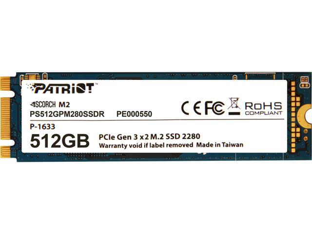

512GB nvme drives are getting really cheap
Example on NewEgg. $57
Patriot SCORCH M.2 2280 512GB PCI-Express 3.0 x2 with NVMe 1.2 Internal Solid State Drive (SSD) PS512GPM280SSDR Internal SSDs - Newegg.com
Problem with M.2 is finding a good board to stack several of these…
