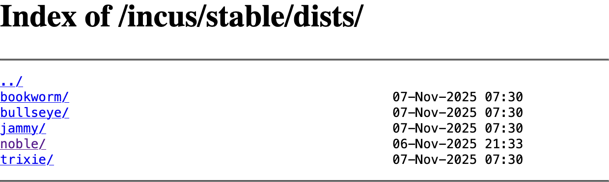

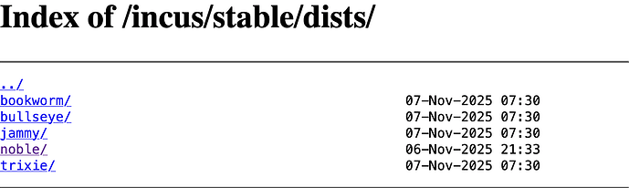

I’m using Zabbly packages and I still have the issue after an update.
I’m on a outdated version of Ubuntu (24.10, I need to migrate it but it’s a pain because of a ubuntu bug with zfs) but I do use Zabbly repository for noble.
Are they the only one lacking the update or it’s because the other ones got the update a bit later?

Hmm, odd, I’m looking into that one now, 8 hours is a very big time difference, so chances are something went wrong during publishing.
stgraber
(Stéphane Graber)
November 7, 2025, 7:48pm
6
I’ve confirmed that the currently available stable package from Zabbly on Ubuntu 24.04 does have the fix and works correctly:
