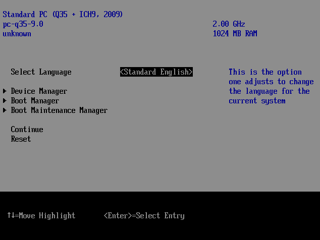

I wonder if you can get into the BIOS and select which drive to boot from via the boot management options and see if that works. Will be a bit tricky with timings to get in but I remember getting into it once to do this. It may enter BIOS if you bash your forehead repetitively and very quickly across the keyboard :smiley: only jokes.
Then we know that it’s just the BIOS boot management that we need advice with.
So I am wondering if there is any option to configure to force to enter bios first ?
Or any chance to delay a console ?
I am struggling …
Documentation link
incus start --console foo
incus start --console=vga foo
(depending on whether you want serial console or graphical console). If you press F2 quickly enough you’ll get into the VM’s BIOS - although I don’t think you should need to.

Does it work if you create and run a fresh VM in incus? That is, maybe the problem is with qemu or the BIOS ROM image.
How did you install incus? If you use the Zabbly packages then they are all-in-one, with a working qemu and BIOS included. But if you use the Ubuntu ones then they have interdependencies with other packages.

For fresh VM created in incus I am able to access to bios via F2.
Problem with BIOS entry which I have is for the vm migrated via bin.linux.incus-migrate.x86_64 tool (which is not UEFI)
