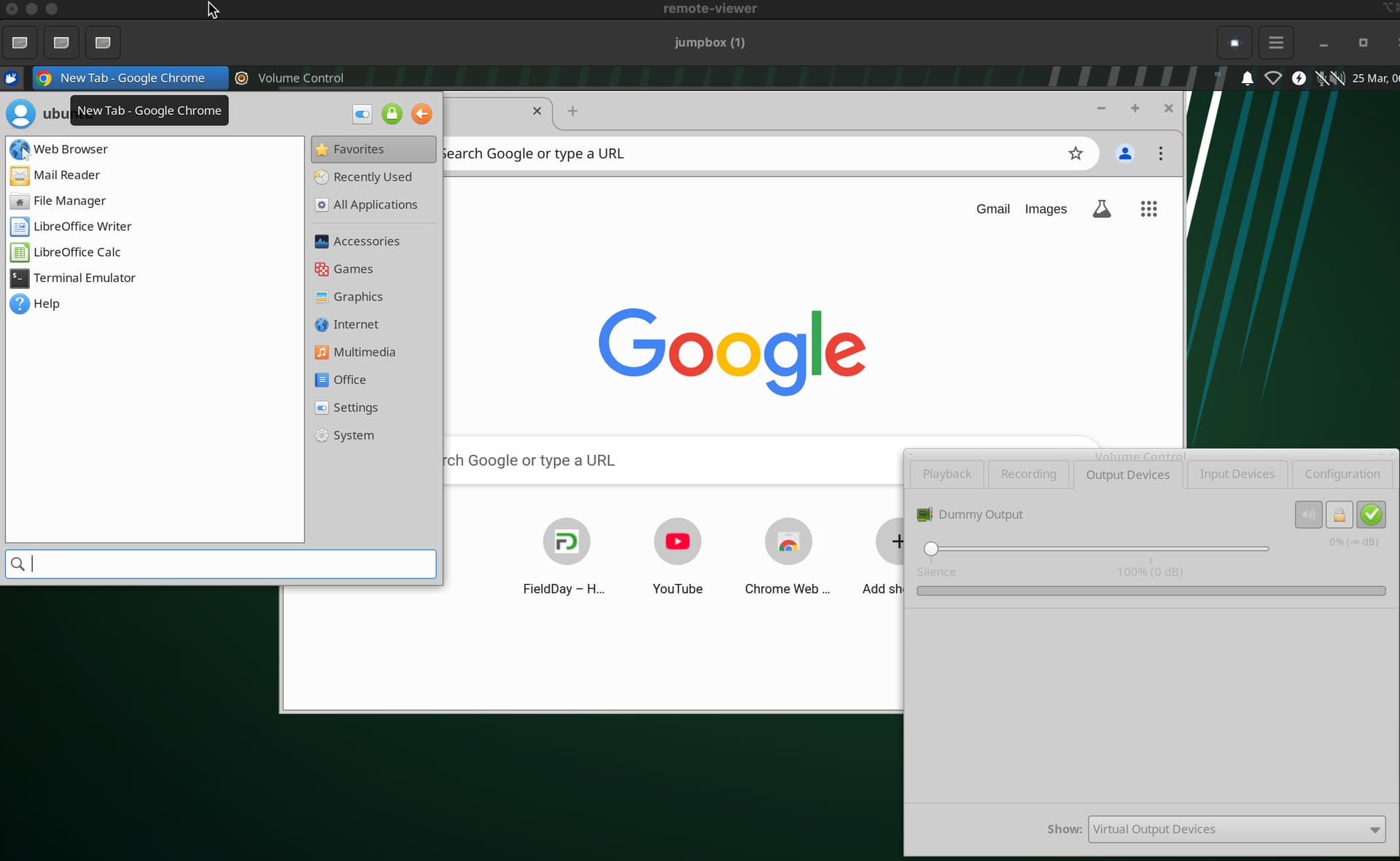

Wondering if anyone managed to get the audio working either thru webui or thru virt-viewer ? I have an ubuntu24.04 vm running and I installed xubuntu-desktop on it. Managed to install google-chrome as well. Everything seems working fine except for the audio part. Not sure what needs to be done.
‘jumpbox’ being my ubuntu24.04 vm with xubuntu-desktop, I tried the command below :
% incus config device add jumpbox sound audio
Error: Invalid devices: Device validation failed for “sound”: Failed loading device “sound”: Unsupported device type
Appreciate any advice/suggestions/pointers
thank you.

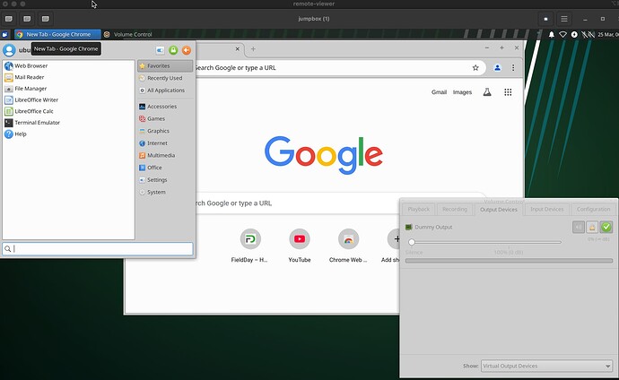

ps: attached is the console via virt-viewer when invoked with the command (on my mac) :
% incus console jumpbox -t vga
Try this command (you may lose sound on the host when vm is working, depends on the sound card I believe):
incus config set <vm_name> raw.qemu -- "-device intel-hda -device hda-duplex -audio spice"
Thanks. Though I am able to control the volume levels now, but I still don’t get audio either from the webui or from virt-viewer.
% incus config set jumpbox raw.qemu – “-device intel-hda -device hda-duplex -audio spice”
Error: Key “raw.qemu” cannot be updated when VM is running
% incus stop jumpbox
% incus start jumpbox
Woohoo!! The audio now works for both using webui and virt-viewer :slight_smile: Thanks @qkiel for providing the command as well as link to the related thread. I followed @stgraber suggestion on installing linux-modules-extra package and that got the audio working after a reboot of vm
# apt install linux-modules-extra-$(uname -r)
# reboot
