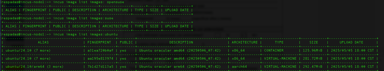

Currently I have incus 6.8 and all my current containers are OpenSuse, but since yesterday when I tried to launch new one, can’t find any openSUSE images, but I can find images for other distributions.
Anyone knows what happend? Thank you.
