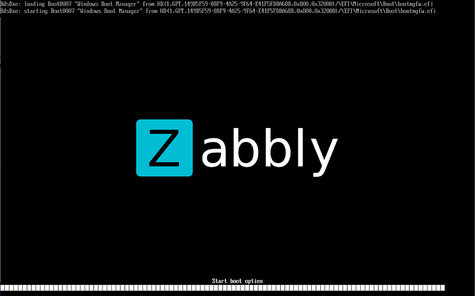

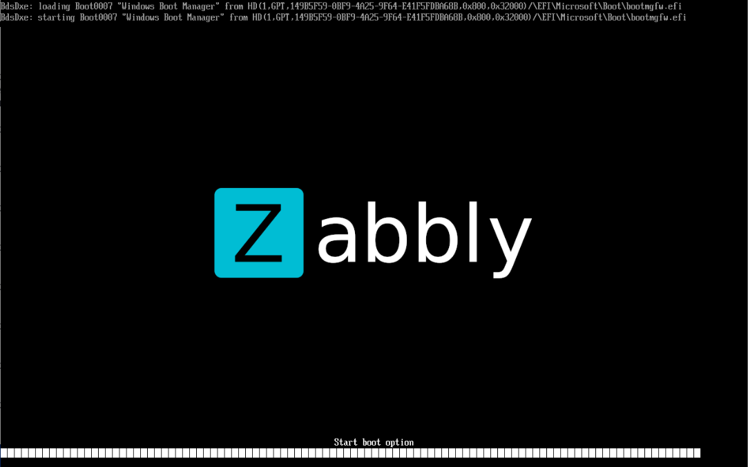

I have a win11 vm which fails to reboot and hangs in the zabby “Start boot option” screen. Normal shutdown / startup works as expected.
Do others have the same problem? In
EDIT: Initially I suspected a failed install of uefi keys was the cause but even when I managed to run successfully the updates to install the keys via powershell the windows vm still hangs on reboot.
So if you shutdown the VM from Windows and then start it back from Incus it boots fine?
The log message you’re showing would indicate that the Windows bootloader was run. Windows won’t be logging anything on the text console after that, so you really need to look at the VGA console instead (incus console --type=vga)
