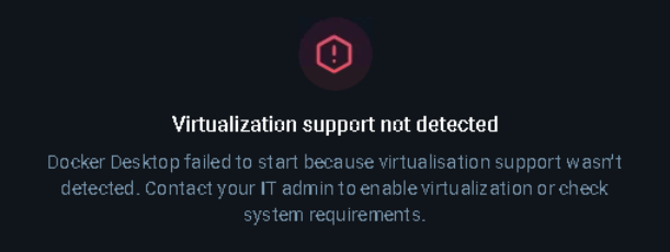

Just setup a Windows 10 Pro VM for a friend and he wants to run docker desktop on the vm. Im a bit confused because its not a container and it should be able to run the docker environment in it.
Now i havent played with windows vm’s in incus much , but everything was setup correctly according to the simos blog post that shows how to create an incus windows vm using distro builder. The windows guest tools drivers from redhat were also installed… and yet i get the following errors when he runs docker desktop.. did i miss something ?
image (1)
Does the host support nested virtualization?

Sorry, I’ve been quite busy lately. I’m not sure what you mean by nested virtualization in containers. To support running virtual machines from within virtual machines, your server needs to have nested virtualization enabled, yes.
As written in @simos’ link, you can check that with cat /sys/module/kvm_intel/parameters/nested (or kvm_amd).

@candlerb so im running Debian 13 and i have nesting enabled… at least from the command you posted …
root@gigabyte:/home/mihai# cat /sys/module/kvm_amd/parameters/nested
1
I don’t know why Docker Desktop or Windows thinks there’s no virtualization available.
Can you try creating a Linux VM, and then running “kvm-ok” inside it? (From the “cpu-checker” package, at least in Ubuntu)
I can run linux VM inside linux VM , which Ive ran fine… but i just thought this was some weird windows issue ?
Quite probably. But it’s still worth checking “kvm-ok”. (You can run a Linux VM inside a Linux VM using qemu without kvm)
@candlerb @bensmrs so ive run the linux vm and running kvm-ok works fine from cpu-checker. I am still hitting this issue with windows VM’s . Any idea what else it could be? I even tried windows 11 with the same issue. Has anyone been able to run docker or virtualbox inside a windows VM ?

I did a query on perplexity.ai. The output suggests that inside the Windows VM you run systeminfo in an elevated Command Prompt, and check everything says “Yes” under “Hyper‑V Requirements”. This includes:
