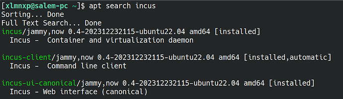

Hello, I installed Incus UI (incus-ui-canonical)
and I setup incus to accept connections on port 8443 but I cannot open the UI
also I see the UI is available in /opt/incus/ui/
Do I miss something?

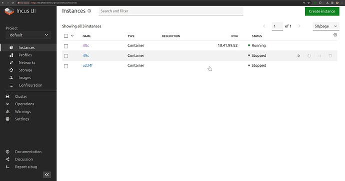

Looks like you set it to listen for IPv6 only, Try:
lxc config set core.https_address ":8443"
thank you
I tried the command and same result, I think [::] mean both IPv6 + IPv4
incus config set core.https_address ":8443"
Make sure your web browser hits over HTTPS, so https://localhost:8443
You may be getting a weird error due to trying to do HTTP over an HTTPS endpoint.
