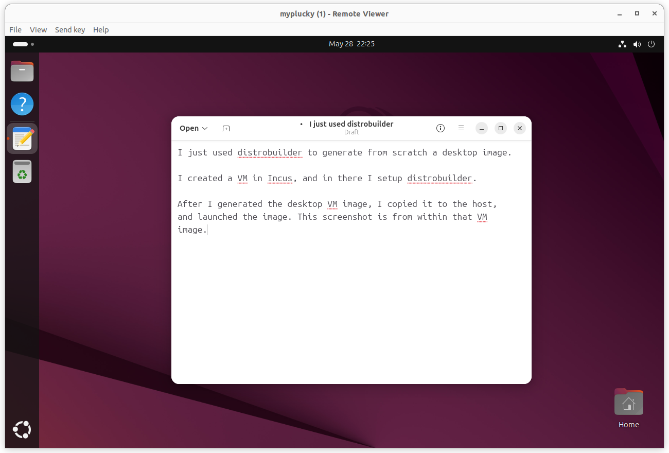

Can you try using distrobuilder in a VM (let’s say Ubuntu 24.04 LTS), generate the Ubuntu VM image, and start it on the host? By doing so, it would be easy to replicate and figure out whether some system-specific configuration is messing everything up, or whether it’s indeed a bug.
Here is me recreating the VM image images:ubuntu/plucky/desktop.
First, I create a VM with Ubuntu 24.04 LTS, resize it up a bit to 15GiB because images require more space than the default 10GiB.
$ incus init --vm images:ubuntu/24.04/cloud distrobuilder
Creating distrobuilder
$ incus config device override distrobuilder root size=15GiB
Device root overridden for distrobuilder
$ incus start distrobuilder
$ incus exec distrobuilder -- su -l ubuntu
Error: VM agent isn't currently running
su: user ubuntu does not exist or the user entry does not contain all the required fields
To run a command as administrator (user "root"), use "sudo <command>".
See "man sudo_root" for details.
ubuntu@distrobuilder:~$
Then, follow the instructions from GitHub - lxc/distrobuilder: System container image builder for LXC and Incus to install distrobuilder from source and set up other packages. The following you can copy-paste in the VM and it will generate the VM Desktop image for you.
sudo apt update
sudo apt install -y golang-go gcc debootstrap rsync gpg squashfs-tools git make build-essential libwin-hivex-perl wimtools genisoimage
mkdir -p $HOME/go/src/github.com/lxc/
cd $HOME/go/src/github.com/lxc/
git clone https://github.com/lxc/distrobuilder
cd ./distrobuilder
make
cd
sudo apt install -y btrfs-progs dosfstools qemu-kvm
wget https://github.com/lxc/lxc-ci/raw/refs/heads/main/images/ubuntu.yaml
sudo $HOME/go/bin/distrobuilder build-incus --vm ubuntu.yaml rootfs -o image.architecture=amd64 -o image.release=plucky -o image.variant=desktop
Let’s check the generated image.
ubuntu@distrobuilder:~$ ls -l
total 36
drwxrwxr-x 5 ubuntu ubuntu  4096 May 28 21:56 go
drwxr-xr-x 2 root   root    4096 May 28 22:12 rootfs
-rw-rw-r-- 1 ubuntu ubuntu 27080 May 28 21:57 ubuntu.yaml
ubuntu@distrobuilder:~$ ls -l rootfs/
total 1327552
-rw-r--r-- 1 root root 1359404032 May 28 22:11 disk.qcow2
-rw-r--r-- 1 root root        724 May 28 22:12 incus.tar.xz
Looks good. Now we get it out of the VM and onto the host. We need to put the generated VM image on the host in order to launch it.
$ incus file pull -r distrobuilder/home/ubuntu/rootfs/ .
$ cd rootfs/
$ ls
disk.qcow2  incus.tar.xz
$ incus image import  incus.tar.xz disk.qcow2 --alias mypluckyimage
Image imported with fingerprint: f9d85959d9b28cb37f4490a4aed5b0d061b188a258ed1d46d0791119af73839a
$ incus image list mypluckyimage
|     ALIAS     | FINGERPRINT  | PUBLIC |                  DESCRIPTION                   | ARCHITECTURE |      TYPE       |    SIZE    |      UPLOAD DATE      |
| mypluckyimage | f9d85959d9b2 | no     | Ubuntu plucky amd64 (desktop) (20250526_16:05) | x86_64       | VIRTUAL-MACHINE | 1296.43MiB | 2025/05/29 01:29 EEST |
$ incus launch --vm mypluckyimage myplucky --console=vga -c security.secureboot=false -c limits.memory=3GiB
Launching myplucky

Your build environment could make a difference. By running distrobuilder in a controlled environment, it makes it easy to figure out if some remnants from the host are causing trouble.
In your case I would build the image in a VM, an Incus VM of Ubuntu 24.04 LTS. You just drag and drop the necessary commands shown above and let it build. It took me about 12 minutes to generate the image inside rootfs/.

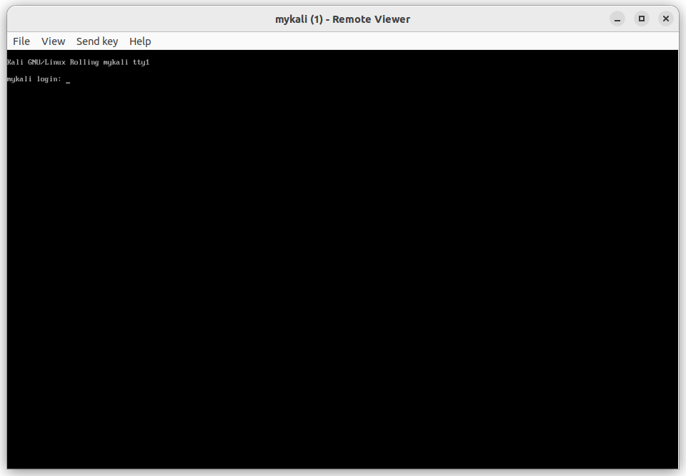

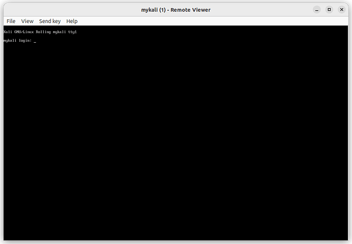

I also tried with an initial Kali VM image. I did not manage to generate a proper desktop image. The file was only about 330MB, hence there was no graphical interface.
However, when I tried to boot it, it booted successfully.
When you say that it did not work for you, can you qualify what exactly do you get?
Because if the issue that you are facing is that the Kali VM does not even boot, then you need to get a Kali image that at least boots (even without the graphical interface).
