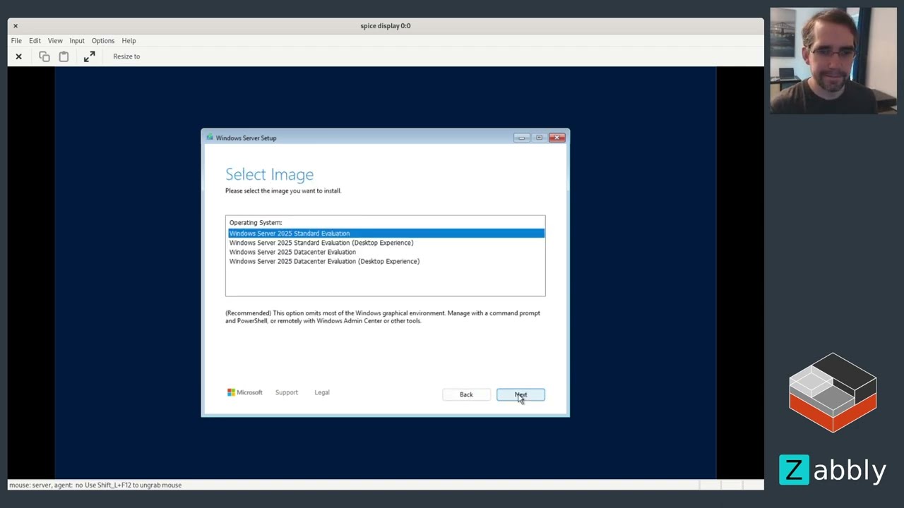

USB CD-ROM handling for VMs
We’ve reworked our USB device setup for disk devices.
Rather than use the most basic USB mass storage driver as was done previously, we now directly set up some of the USB block transfer layer.
The main benefit from this is that attaching an ISO to a VM on the USB bus will now correctly result in a virtual CD-ROM drive being exposed to the VM.
With this, it’s now possible to attach the Windows install media and VirtIO driver media to a VM using io.bus=usb and directly boot and install Windows without needing to rely on ISO repacking through distrobuilder.
