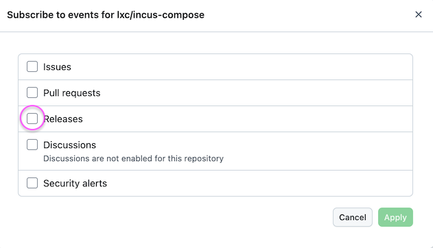

In general, I don’t like software that auto-updates, especially if I can’t turn it off. Updates are supposed to make things better, but often break things. If I can correlate breakage with an update that I just did myself, then I have a clear cause-and-effect relationship. If things just break one day for no apparent reason, then it’s much harder to diagnose.
Anyone who wants to keep up with incus-compose can just subscribe to releases on github: click on Watch > Custom >
Having said that, if you really want an auto-update mechanism, then:
  1. Make it optional
  2. Check no more than once every 24 hours (otherwise it slows down normal workload and puts unnecessary load on github)

Sorry I never responded to that, having users “watch” the project sounds far better than and update check, thank you!
