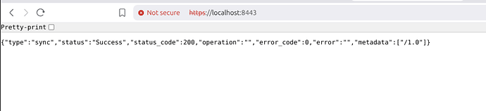

zara
(Yassine Zara)
May 26, 2025, 9:41pm
7
it is https. see the picture https://localhost:8443 , the warning (Not secure) is due to self signed certificate.
