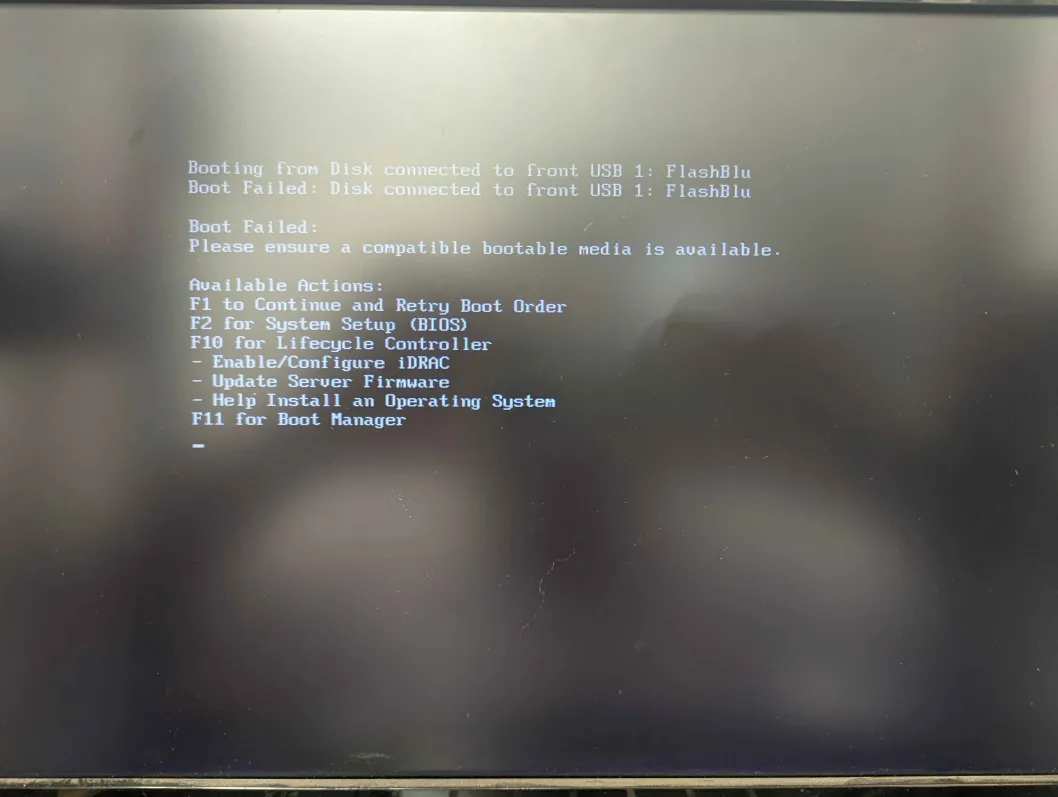

I was recently informed of IncusOS by a friend on a networking server, and have been attempting to install to no avail for several hours now. I’m on a Dell PowerEdge R450 and using the web-based image generator, but every time I attempt to boot from USB—either the .img or flashing the .iso using something like Rufus—it detects the USB drive in the boot screen, but then fails to detect a compatible bootable media on the drive. I am using as bone-stock of an installation as I can, telling it to use whatever defaults are set, and am not sure how else to proceed. I have SecureBoot enabled, have deleted all my KEKs and db certificates except the one indicated by the guide, and have TPM enabled.
Apologies for the literal screen shot, I haven’t a way to capture the screen at the moment.
Two hopefully obvious things to check:
  • You’re directly writing the .img to the USB stick via something like dd, rather than copying the .img file onto an already-formatted USB stick
  • The server is booting with UEFI, not legacy BIOS
We’ve also seen some servers that required the Microsoft or other vendor db certificates to be present for storage/network hardware to properly initialize. I’d be surprised if a USB controller required that, but you might try resetting the Secure Boot certificates, then replacing PK/KEK with IncusOS and appending IncusOS to the current db entries.
