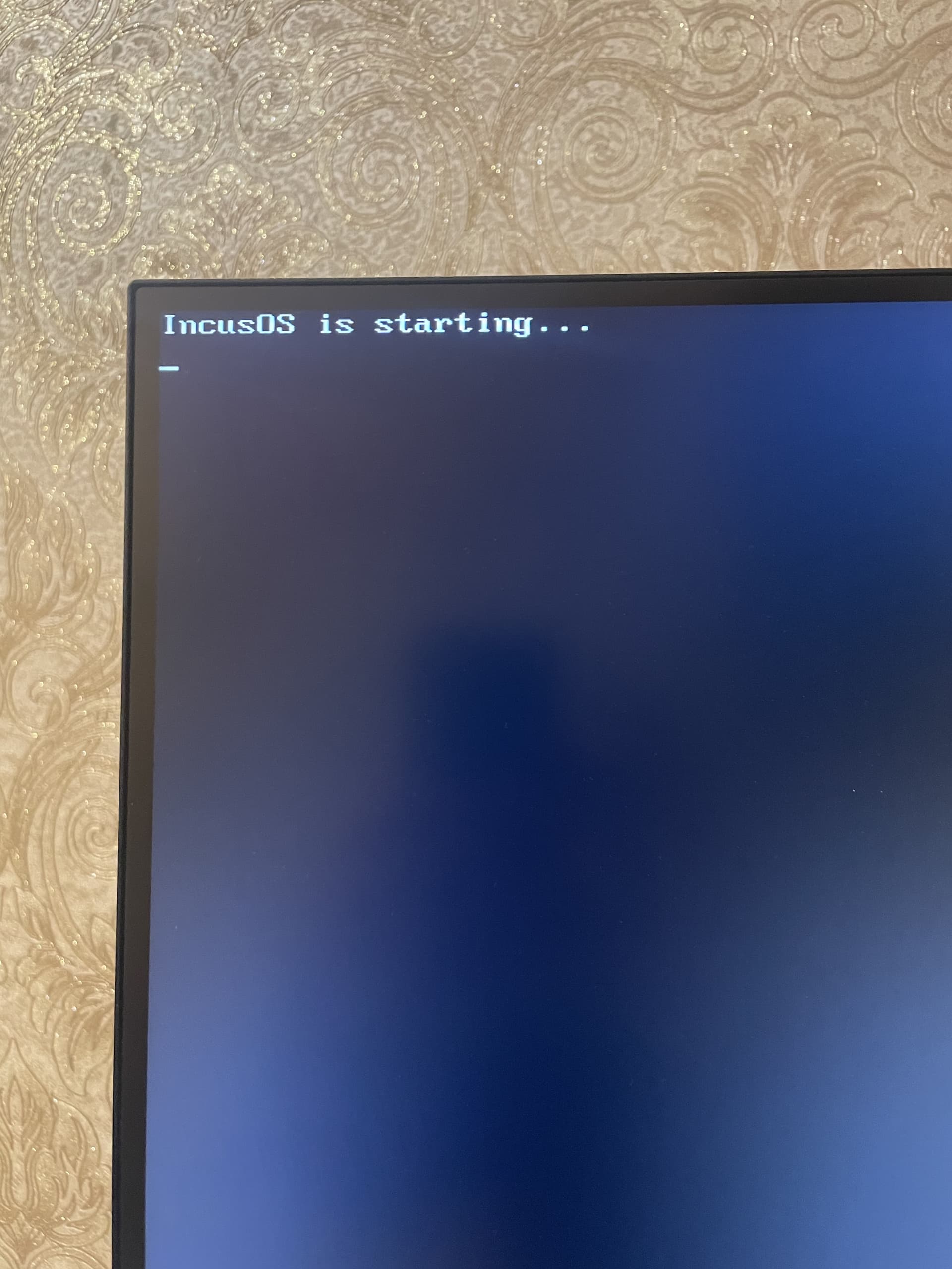

IncusOS is Starting indefinitely
I’ve just installed IncusOS but it has no indicator of progress upon starting, just showing the starting message.
Is there a way to see logs?
Give it 10-15min, then it should hit the actual timeout.
This is usually what we’d expect if the storage controller in your system isn’t supported by the IncusOS early boot (initrd).
If after 10-15min you get a timeout error, it’d be very useful if you could boot that machine on a traditional Linux distro like a live desktop image or something and then give us a dump of lsmod and ls -lh /sys/class/block/*/device/device/driver.
We basically need to pin down what storage controller driver is used by this system, then we can add it to our initrd so a future image will boot correctly after installation.
We can also make a bit of a guess as to what this may be if we knew more about the machine. What CPU vendor is this? When was it built? Is that a NVMe or SATA drive?
(Note that there still won’t be much of a log or shell access after the timeout, but it would confirm that we’re dealing with a storage issue at least)

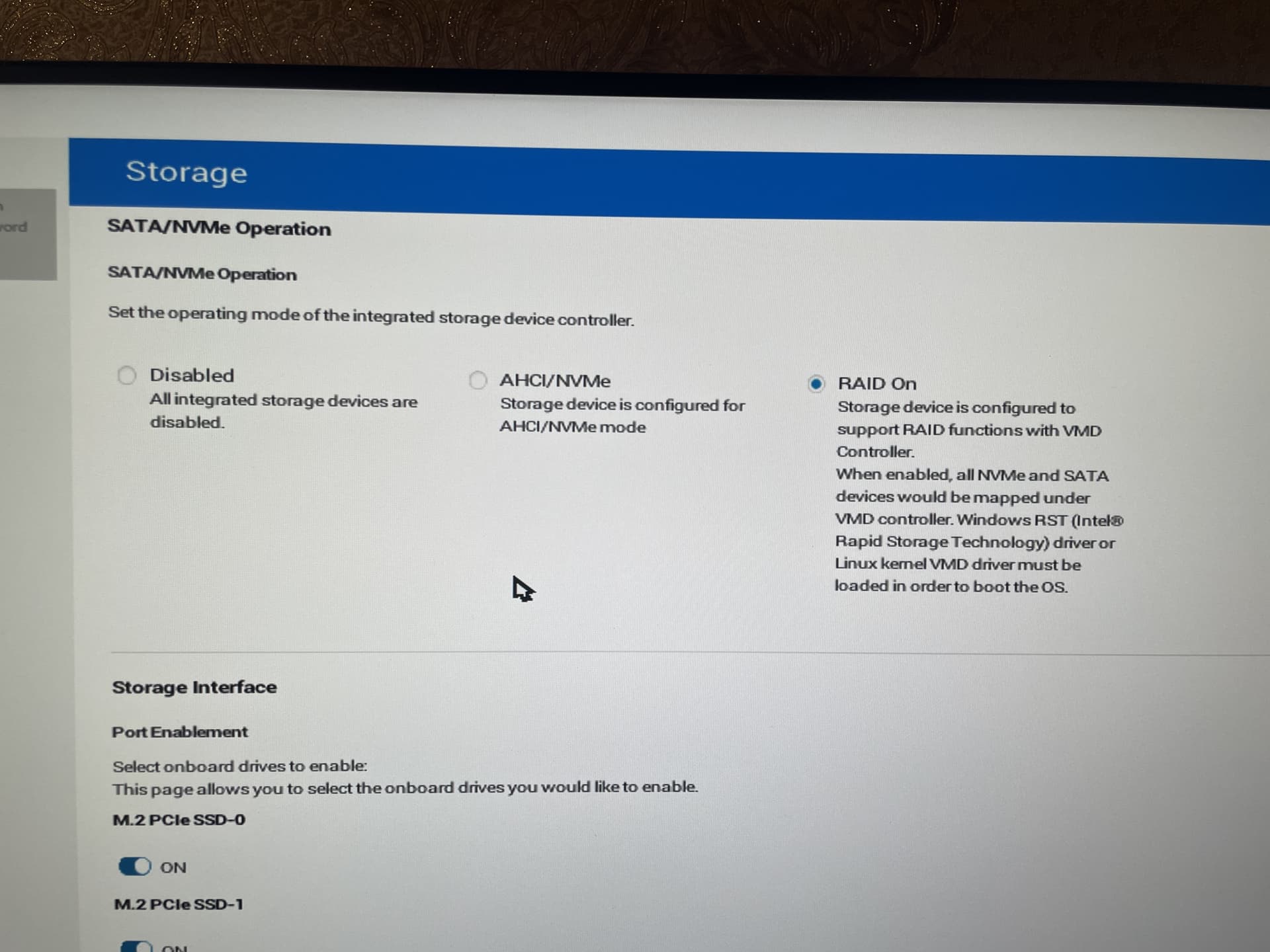

It’s Dell OptiPlex Micro 7020. It also had problems shutting down when installation finished, had to power-off.
Okay. The first thing I’d do is go in the BIOS and see if they have storage modes in there. If there is something like “RAID” mode, turn that off, you want the drives to be directly accessible to the OS.

Were you able to check your BIOS for any setting related to RAID or Intel VMD which could be causing this issue?
From what you’re showing, this should be a pretty standard NVMe set up, so I’m wondering if there’s some weirdness coming out of the motherboard here.
You are correct, it was in BIOS mode indeed. I’ve put it to nvme mode:
I’m not sure if that was the thing which helped or that I just didn’t wait enough last time, after 3 minutes it boots further now.
Yeah, it probably was the issue. I’ll look at including that Intel driver, though in general you get better performance when you have those kind of built-in RAID features disabled (unless you’re actually using it for RAID).

I’ll make sure we have uas in our early kernel modules as well as that Intel RAID driver so we can hopefully quickly solve both.
base: Add Intel vmd driver by stgraber · Pull Request #537 · lxc/incus-os · GitHub should take care of the most common Intel RAID mode issue.

Disk is AHCI. I have the same output loop:
IncusOS is starting…
You are in emergency mode. After logging in, type “journalctl -xb” to view
system logs, “systemctl reboot” to reboot, or “exit”
to continue bootup.
Cannot open access to console, the root account is locked.
See sulogin(8) man page for more details.
Press Enter to continue.
Reloading system manager configuration.
Starting initrd.target
Are any additional details that I can share? Maybe is the Lenovo m710q Tiny…
